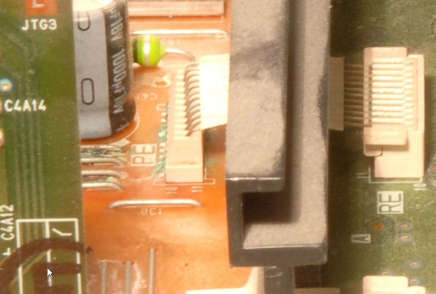

Great news! I yanked the chassis, and found a jumper that had been corroded down to a thin filament. Also found some spongy green scuz that, if conductive, was shorting two wires together. I buzzed out all the board to board connections with a low-current ohmmeter and found them to be in good shape. I checked several vias on the double-sided board and found those all to be fine as well. I wonder if some of what appeared to be a large area of previously-wet board was something left over from manufacturing, perhaps a final cleaning process. The real problem turned out to be on the center single-sided board in this area right behind the "jungle" plug-in board:
I cleaned up that green stuff and replaced the severely corroded jumper (obscured by the jungle board in this image). I slapped the chassis back into the set and it fired up and it is working fine. Now I've go to get some vinyl siding to make a drip tray.
