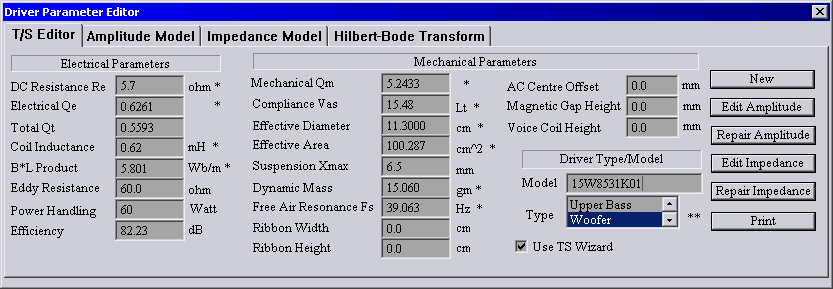

Based on my initial UniBox calculations, I have decided to go with 2 Scan-Speak 15W/8530K01 for the Bass/Midbass, and I am unsure what I need to compliment it. Does this design want a tweeter, or a wide/full range driver between these 2? I am basing my design on the KEF KHT9000's.
This is a sealed enclosure, measuring about 11.5L. It's a large wall mount to be sure, but it works OK for the space that I have.

11.5 liter enclosure is way too small for two SS 15W/8530K01!
If you want a small sealed enclosure and SS Revelators, the lower Qts 15W/8530K00 version will be better suited. Even with that, 11.5 L is a bit too small.
BTW, consider my offer I made in your "wall mount speaker" thread. I initially thought you were looking for a "in-wall" design, but it seems that it's actually "on-wall." Anyway, if this is your first DIY build and your SQ standard is not extremely high, using the SS drivers is, in my opinion, somewhat risky unless this is cost no object. The Dayton or HiVi drivers I recommended can also make a great sounding design.

Jay_WJ wrote: View Post
According to Unibox, the actual volume would be 4.8L per driver in a sealed enclosure, with a Qtc of .85. (I believe the Qtc was .85, but I don't have my data in front of me)
I am considering also using the Dayton RS150-4's. Of course, I'm also considering scrapping this whole idea, and going with an array of FR's.

Re: Speaker enclosure building advice needed
Qtc of .85 is somewhat high. People usually want to keep it between .5 and .7. In addition, Scan Speak's published T/S parameters aren't very accurate. Take a look at Zaph's 15W/8530K00 and 15W8530K01 measurements:
Take a look at Qes (Electrical Qe) and Qts (Total Qt), and use these values in your Unibox sim. You'll get different Qtc and curves.
BTW, using FR drivers doesn't necessarily mean no filters. They often require filters for response correction and even a touch of BSC for on-wall designs. I think the Dayton RS150 and RS28 MTMWW (or WWMTM) design I
