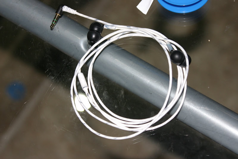

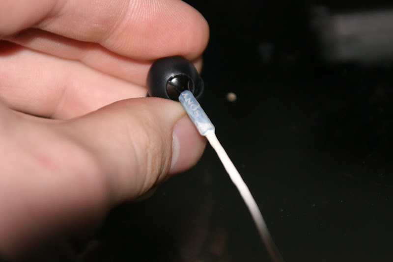

Here are the pictures I mentioned The headphones are Sony MDR-EX55, the teflon tape shown has been applied for ~2-3 months now and has received regular use.

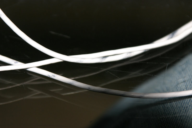

You may notice some areas are more translucent; after applying pressure to the teflon wrap it appears to squeeze some air out and make a better 'bond' (as if you were to stick scotch tape to paper and then press it on with your fingernail). For those who have not used pipe thread tape before, it is a bit like Saran wrap/Glad cling wrap though there is less stretch to it.

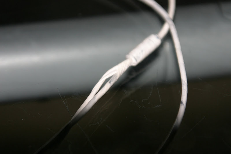

I used my thumbnail (the 'flat part' not the edge) to press the teflon down, causing the translucence shown below.

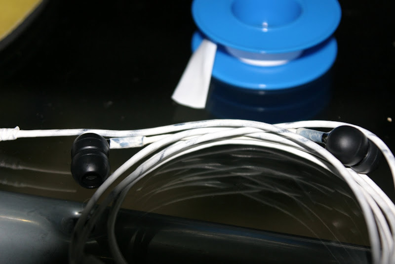

Shown below is the 'termination point', the teflon is wrapped starting at each ear-bud and stops at the branching point shown here. From the termination point, I then wrapped towards the plug.

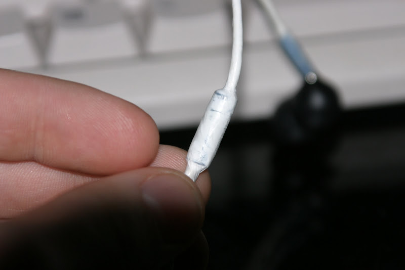

This shows the translucency on the cord, I realize it does look like there is only one direction of wrapping, however there are two layers, in opposing directions.

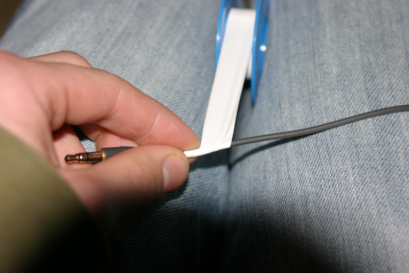

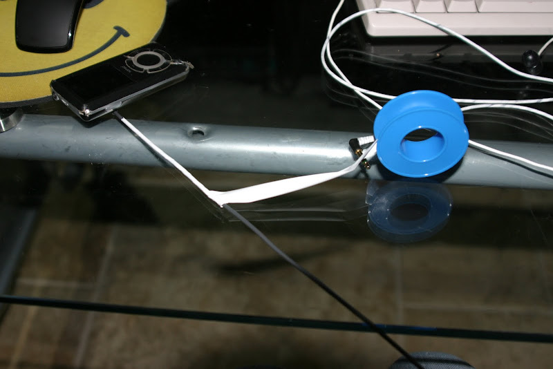

Here is a 'demo' of the wrapping using my pair of JVC HA-FX34 'marshmallow' headphones. The cord around the ear-buds has already hardened (from skin oils) so I did not cover the entire cord, this was just to show some of the application methods I have figured out.
If you pull/stretch the teflon tape so it is a bit "wider" it can aid in a smoother application. It is also helpful to try and keep the cord taught while wrapping.

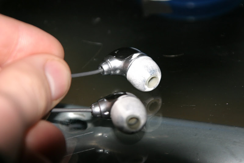

I mentioned the marshmallow ear inserts getting hard from oils too (this is my second pair of 'marshmallows' to do so) using three 1" long strips of teflon, I managed to wrap them around the foam ear inserts
