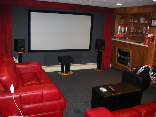

My room is currently setup as a 5.1 setup but my receiver can be setup for 7.1 surround. I'm wondering if I would get much benefit adding two more surrounds. I would think that room size would have a lot to do with it. My room is 13" X 15" but open on one side.

Given the size of the room it would be more beneficial to make sure your acoustics are addressed properly. There are very few 7.1 dedicated movies out there and unless your room is large with two rows of seating 5.1 is good enough.

I read a few things mentioned in here that I have to disagree with. If your receiver does Dolby Pro Logic IIx, which just about every receiver made after 2005 does, it will take the discrete surround channels and intelligently matrix them into the rear channels. The bitstream is still DD 5.1 or DTS 5.1, the Pro Logic IIx just layers on top of it and only affects the rear surrounds, all of the 5.1 stays untouched.
So any movie, video game, or other media that has a 5.1 track can be played as 7.1, and yes, this does make a noticable difference - to me at least.
I would say that rather than room SIZE determining if you should go 7.1, room LAYOUT is the primary factor. If your seat is against the back wall, don't do it. If your surrounds are already on the back wall, don't do it. If your seat is away from the back wall and your surrounds are to your sides as they are supposed to be, then yes, I would recommend you go for rears. They should make a noticable difference (improvement) in the surround aspect of your experience.

I have to agree 100% with what you have said...it actually is more about seating placement then room size...this being said.. a good friend of mine has a 7.1 surround system in a room that is 16ft long by 9ft wide...and the thing sound amazing.
I am a long time fan (10 years+) of 7 channel surround as it gives you a far more surround enveloped feeling then 5 channel.

Thanks for the great info. My current setup is running side ways in the room, so my couch is against the back wall. My surround speakers are on the sides of the couch on the wall. The other half of the room has a bar built into it and there is also a lolly column that separates the two areas. My dream is to install a new beam and remove the column. Then I would be able to run the theater the long way in the room. I would also have to rebuild the bar.
