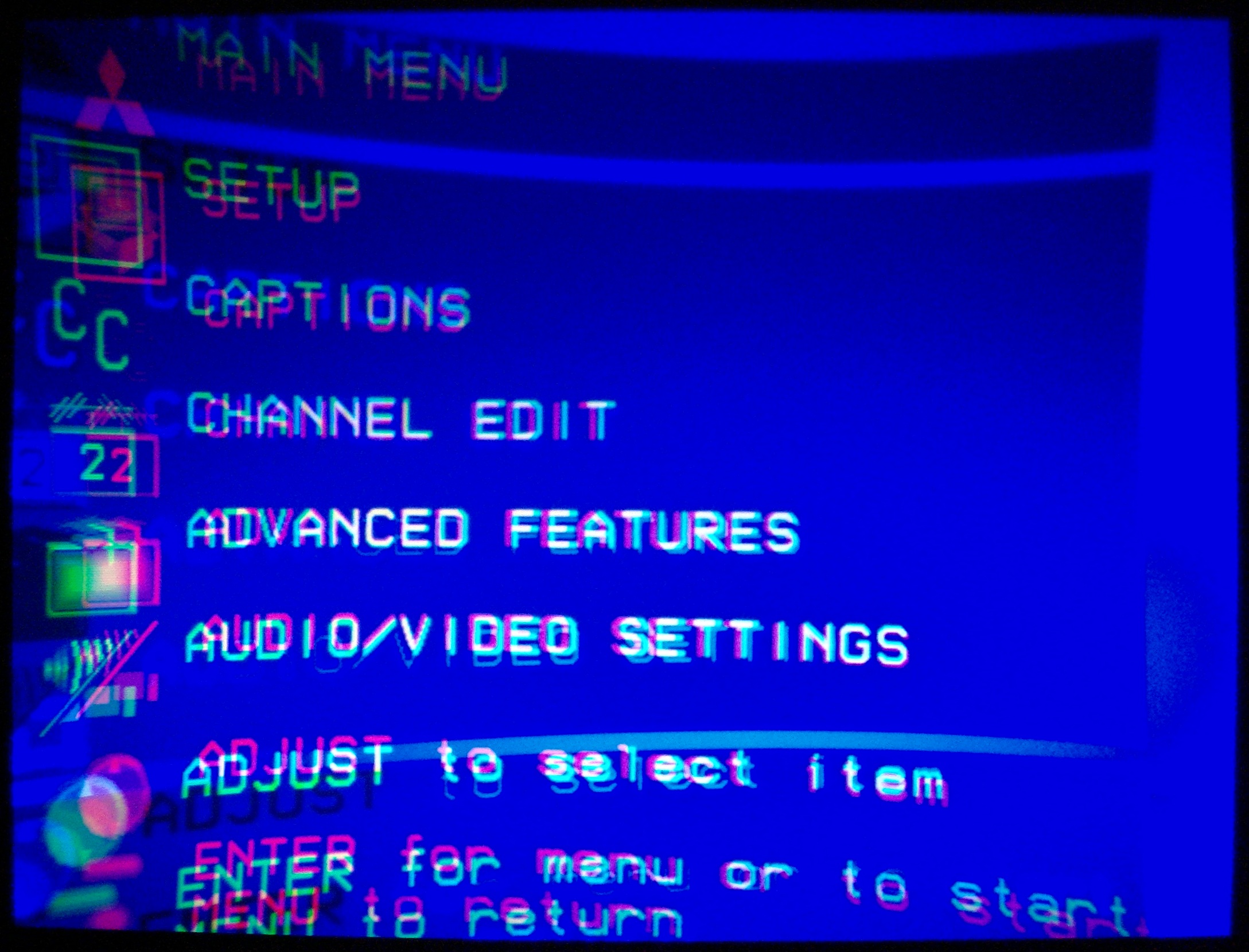

I was watching a baseball game in HD on my Mitsubishi VS-50805 last night when suddenly the picture went black. Still had audio but no picture. When I pressed the 'MENU' button on the remote I got this lovely display:
I tried the usual tricks like turning the set off for several hours but saw the same thing when I turned it back on. I get this same symptom on all inputs. I suppose this could be a convergence problem, a massive one that affects all colors, or a mechanical problem like a bracket breaking or something in the optics path moving. The thing that's strange is that the picture video is gone but the menu graphics still work. Any suggestions on where to start?

Your image indicates a convergence problem. The fact that you lost video at the same time is unusual for a convergence failure. What is common on this set is for coolant to leak onto the circuit boards from the CRT. It is very important for a coolant leak to be handled properly for a reliable repair. The location of any coolant on the board(s) needs to be mapped carefully and the boards removed and cleaned carefully to not expand the problem. It is best to find a tech that has done lots of these to do the job, though in many cases it is possible to DIY.
Look carefully for wet spots on the metal frame corners on the crts and on the boards. Use the markings on the sides of the boards to map the locations as coordinates BEFORE the boards are removed.

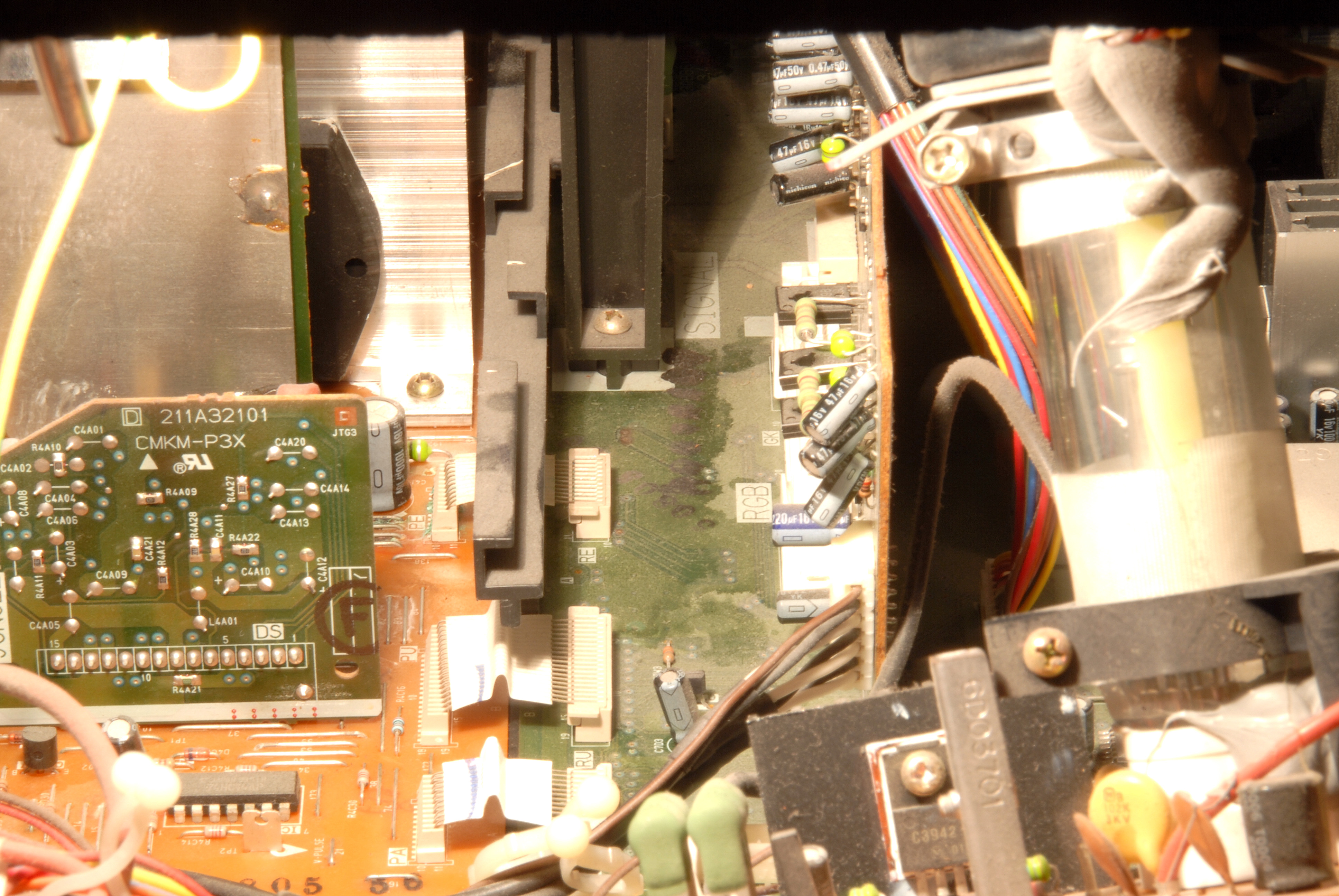

Good/Bad news! I couldn't find evidence of a coolant leak and wasn't comfortable ripping into the set, so I called a TV repair service. Their tech came out popped open the front of the TV (why didn't I think of that?) and pointed directly at a spot under the blue tube on the right side of the set. There was evidence of a sizable lake there that had since dried up. I was so impressed I took a very high resolution image of it:
The "RE" connector on the green board appears to be completely surrounded by the discoloration. If you zoom in on the image you can see some vias that are discolored in that region of the the RE connector. What's not as obvious is the damage on the tan PWB on the left. If you look at connector "PE" that mates with "RE" you can see some green fuzz on the pins, and some more on the jumpers to the left of it. There are bits of residue elsewhere as well.
The tech told me that their firm will only replace these boards, they will not rework them. He also told me that the boards are difficult to come by (and later verified that he couldn't get either of them for me). One other interesting note, he said that the blue tube is particularly susceptible to leakage because it runs hotter due to the higher opacity of the blue filter.
Anyway, since replacements are apparently not available, I've got nothing to lose in trying to fix this thing myself. I've done a lot of work on multilayer PWBs, but I do have a couple of questions on how to get into this thing:
1. Do I go in there and disconnect all the external connections (around a dozen) to the entire chassis and slide it out, or is there some way of getting just the boards out that I need to work on?
2. How do those board to board connectors work? I noticed when I looked at the picture at 100% resolution that the "RE" connector that most of the top of that connector comes off. Does it pop out entirely or does it open like a door? They don't seem to open easily - is there a technique or tool required?
Any advice is appreciated. Also, feel free to snag that picture and use it as you see fit. I might have found that stuff earlier if I had seen such a picture.

Lots of shops don't want to take the risk of fixing these, because if you are not thorough, it is easy to miss something. If you don't do it very carefully, you can have lots of issues down the road. Frankly, the fact that you could miss this leak indicates that you may not be a good candidate to repair it, but as you said, you have little to lose.
Do EXACTLY as I describe. Note the numbers and letters around the edge of the boards. Use these as coordinates to make careful notes and a map of the areas and components affected. On the green board(signal board), you MUST consider the feed-through holes components that need to be tested and repaired. These are the source of most problems that people miss when repairing these boards.
After mapping the area of the leak as well as you can, pull the chassis. Yes, disconnect all of the connectors and pull it out. Then you can remove the boards from the frame more easily. The white connecotrs just snap up. Pull evenly on the two tabs on each side, straight up. After removing them, go over the boards very carefully and verify your map of the affected area. Pictures are very helpful to refer back to. Then you want to gently brush or scrape the corrosion off of the components and scrape back any traces that are darkened to the bare copper(remove the green coating). To do this I use an angled blade and a pick and a fiberglass brush. A stiff tooth brush can work oK as well. Washthe boards in isopropanol or denatured alcohol as you are brushing the leads, connectors and components to get the corrosion and goo off. Once corroded areas are clean down to the metal, let the board dry. If there is a white residue, just brush it off when completely dry. Handle the boards carefully.
Now repace any components with corroded legs and repair any connections or traces that are corroded through and/or lack continuity. You have to check each and every feed-through hole on the signal board for continuity in the area that had coolant. Depending on how long the coolant was there, you may have none that are bad or you may have many. If you find one that is not continous, scrape back the coating to the metal on each side, take a strand of copper wire and feed it through the hole, then solder it on both sides.
After repairing the boards, run them through the dishwasher. Yes you read correctly. This is a trick that I learned from an engineer from Tektronix, the test equipment manufacturer. Use regular dishwasher detergent and a dry cycle. Stand the boards on edge so the water drains and it dries better and be sure that they are supported well.
If you have repaired all of the connections and components damaged by the coolant, you will have a high probability of a fix. If the set does not work properly at that point, there may be some component damaged by a short,but this is rare. It usually means that you missed something or damaged something in handling, so be thorough and careful. Put the boards back in after they have dried thoroughly, as water and solvent can hide under the chips. This is why the dry cycle on the dishwasher is important. If you don't have one, dry the boards in the sun for a day. Berfore you reinstall, be sure to clean off the frame and clean any coolant from any wires or from the CRT brackets. Add a gutter under the tubes to divert any future leaks. I use an angled vinyl siding cut to fit the width of the chassis. If the tube keeps leaking it can be resealed, but this is not typical.
If you still have problems and need to do any troubleshooting, you will likely need a scope and a service manual, along with troubleshooting skills and circuit knowledge.
Good luck. Be very careful and very thorough. Do not force any connectors. If you break them or break the boards, you are unlikely to find replacements.

Great news! I yanked the chassis, and found a jumper that had been corroded down to a thin filament. Also found some spongy green scuz that, if conductive, was shorting two wires together. I buzzed out all the board to board connections with a low-current ohmmeter and found them to be in good shape. I checked several vias on the double-sided board and found those all to be fine as well. I wonder if some of what appeared to be a large area of previously-wet board was something left over from manufacturing, perhaps a final cleaning process. The real problem turned out to be on the center single-sided board in this area right behind the "jungle" plug-in board:
I cleaned up that green stuff and replaced the severely corroded jumper (obscured by the jungle board in this image). I slapped the chassis back into the set and it fired up and it is working fine. Now I've go to get some vinyl siding to make a drip tray.
I'm glad I didn't have to buy a new TV. I was out looking at LCD and plasma HD TVs this past week and was not impressed with what I saw. The high-speed update that these new screens have really brings out the "blocky" encoding artifacts in the MPEG images, particularly at scene changes and in scenes with a lot of motion in them. There is some new technology just now appearing in very high-end screens that cleans up a lot of those artifacts. I hope the old Mitsubishi can hang on for a couple more years until that post-processing technology makes its way into the mid-range (~$2,000) 47" screens.
