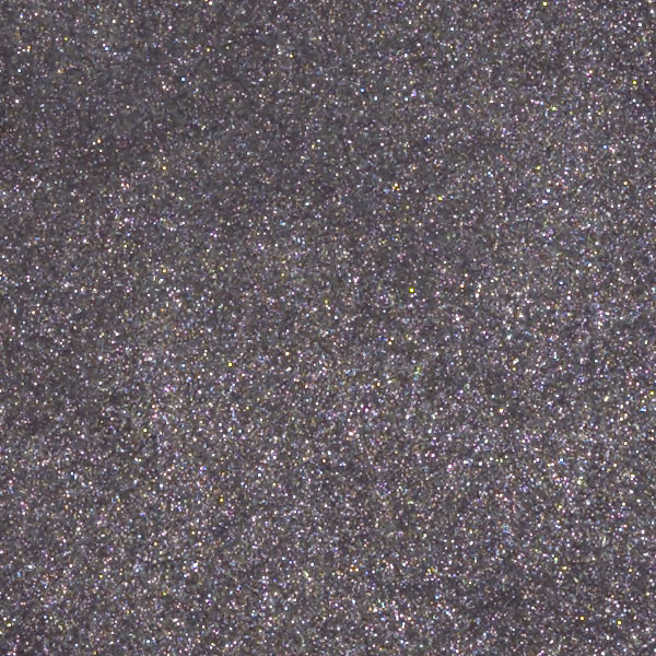

With just a 10X magnification the color separation is easily seen with Jacquard Pearl-Ex Silver.
This is just a fact of what mica (pearls) do. It's why they are used by artists. Non-interference materials are opaque and do not allow light to pass through them, so the light is not refracted. Mica is a trade off that's been used for years. It makes for a brighter image, but causes color shifting. Aluminum (non-interference) also creates a brighter image but doesn't have the classice mica rainbow color shift effect.

Even with a DLP that just has an RGB color wheel, it is additive color. All colors combined create white in an additive color system. With paints it's a subtractive system and when you add all colors you get black.
Rarely does a projector put out just one of the primary colors. It is creating a complex image of light and colors created from the primary colors in the color wheel or the LCDs in an LCD projector. When light is refracted, it is broken back down to it's individual colors, hence the rainbow prism effect happens. I'm not being argumentative at all, this is the nature of mica is all.
Iridescent materials are covered in detail here.
There are also different grades and quality of mica, which also are a factor. Lower grade mica/pearls tend to have less consistancy between flake sizes, thickness, density of how many flakes per bottle... lots of variables, but they all do have a common characteristic...
Aluminum is a non-interference that is also very bright and reflective, which is exactly what sparked the interest in using it. We can go darker in shade, add more aluminum, and still maintain whites, blacks, and color reproduction.
