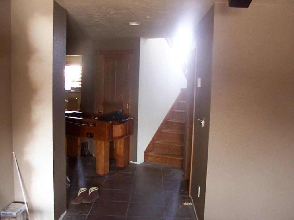

pics before paint
screen wall
window to the right
Old 02-15-08, 04:59 PM   #9 (Link)

Ok decided to paint now since everything was still out for painting the rest of the colors. Of course i had to break out the pj to see where to paint. Im not sure what you guys do but i did a 2" reveal on all sides of screen of extra screen paint. Might follow that with some black fabric later. Do you guys paint exactly the screen size or how do you go about it?
Some shots of screen. Window treatments arnt here either yet so some screen shots will be later tonight.
The second coat of BW started to show the alluminum reflections.
flash only.....i think im too close will try more tonight
