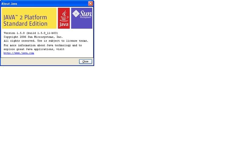

Old 04-19-07, 11:17 PM   #60 (Link)
Alias: koiman
Loc: Antioch, California
User: #5399
Since: Jan 2007
Posts: 50
koiman is offline
Re: Sound Card Calibration
MakeFlat,
I set all the sound settings to sound blaster and tried to run the sound card cal. and still same situation.
Here is a photo of my Java.. This is from the java icon on the control panel.. it checks every 30 day's for updates.
Thanks,
Leon
Old 04-19-07, 11:24 PM   #61 (Link)
Alias: Nick
Loc: Seattle, WA
User: #7848
Since: Mar 2007
Posts: 89
MakeFlat is offline
Leon,
See if you can bring Java Runtime Environment V5 to the top. I don't know how that was done since I installed JRE 6.0U1. Anyway, the instructions for installing JRE V5 is explained in:http://www.hometheatershack.com/roomeq/
Edit: It may be that JAVA 2 includes JRE V5 Update 10 but I am not aware of that, not being a JAVA expert.
Nick
