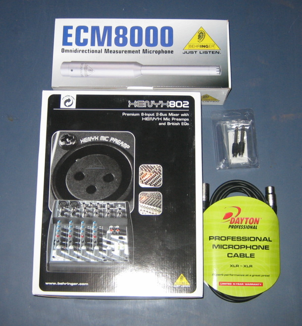

Hi Drizt
you'll need a mic obviously, and about the cheapest is the behringer ecm 8000, around $100 here in Australia, prob less if shop around. Use the generic cal file off the shack.
Then you will need to get those measurements into the computer, so some sort of mixer with phantom power is reqd. I use the behringer xenyx 802, about $110 but shop around. With Behringer gear they usually give you a discount straight away!
mic leads, not expensive say $20 a pop, and even a mic stand from any old music store, say $50.
Still use the R/S meter to set the sound level (I don't usualy bother with it, as long as I have a good signal I just tell it it is 75 db and off I go).

Just curious, how is the behringer gear regarded in terms of accuracy?

Ultimately I suppose it is not as accurate as some (most?) but then again, it all depends on what level of accuracy you need.
It is certainly more accurate than the R/S meter (isn't it?? ha ha) and gets the job done.
If you are using it to get an idea of what you mains are like FR wise (else you wouldn't need full range measurements) who cares if it is one or two db out here and there, as you won't be doing anything to change it anyway!
If you use it from your seat then it matters even less that it might be out a bit, and a mic costing ten times as much will not give you any more information in that situation anyway.
