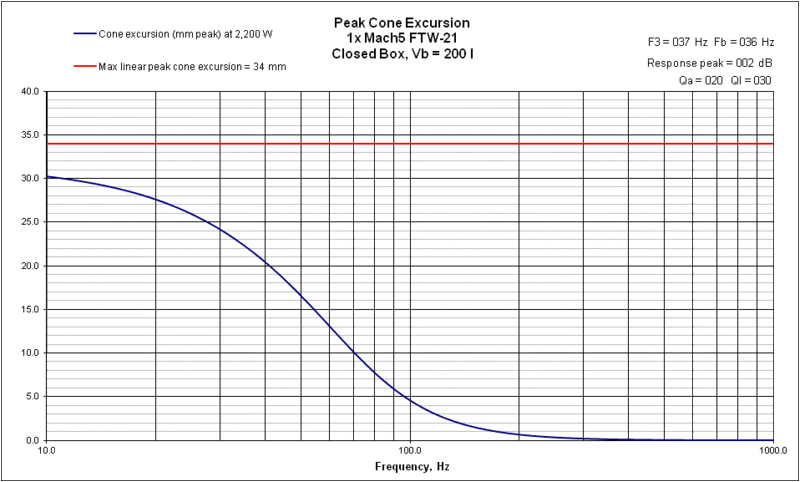

What would you do between 4 18" IXLs or 2 FTW 21" drivers. Looking to go sealed from ported. Yes I know, I didn't think I would end up thinking about it. I am waiting for a price back from Mark at IST about shipping to the UK but it would be good to get some opinions. 4 IXL's would be cheaper and yes there's no replacement for displacement.

Two 21's would need a 9 cu ft each sealed and 4 18's would only need 7 cu ft for each dual. I was originally looking at 8 JBL GTO-1514 15" drivers and I can get 8 off those for £600 delivered and would mach the spl off both the Mach audio's and would only require 2400 watts input power. They would however require a 15 cu ft for each dual. I am thinking off different options as I would like to go sealed but match the spl of my ported Q's.

I like overkill but just love the thought of looking at two 21" drivers with 34mm of excursion.

did you model 2 21's vs 4 18's? if so, what does it look like?

You don't need 9 Cubic feet for the 21's, 5-7cf will work great and 9cf is not needed at all. The gain over 6 cf is not worth th extra size if you can eq.
If it was up to me since I have 4 ixls right now and will be the first to get the FTW's, I go with the 21's hands down.
91 Posts
Ya but I'm sure you are going to EQ (I'm N8DOGG on avs) and the extra size doesn't gain you a whole lot. If you have no plans to eq then 9cf is good to go. I'm modeled every size from 5 to 10 and the sweet spot IMO is 7 but if you have the room and don't care, 9 would be fine. If you went with 6, you could eventually get 4 and stack them and the 2 subs wouldn't be much bigger that. What are you going to be running for amps?
