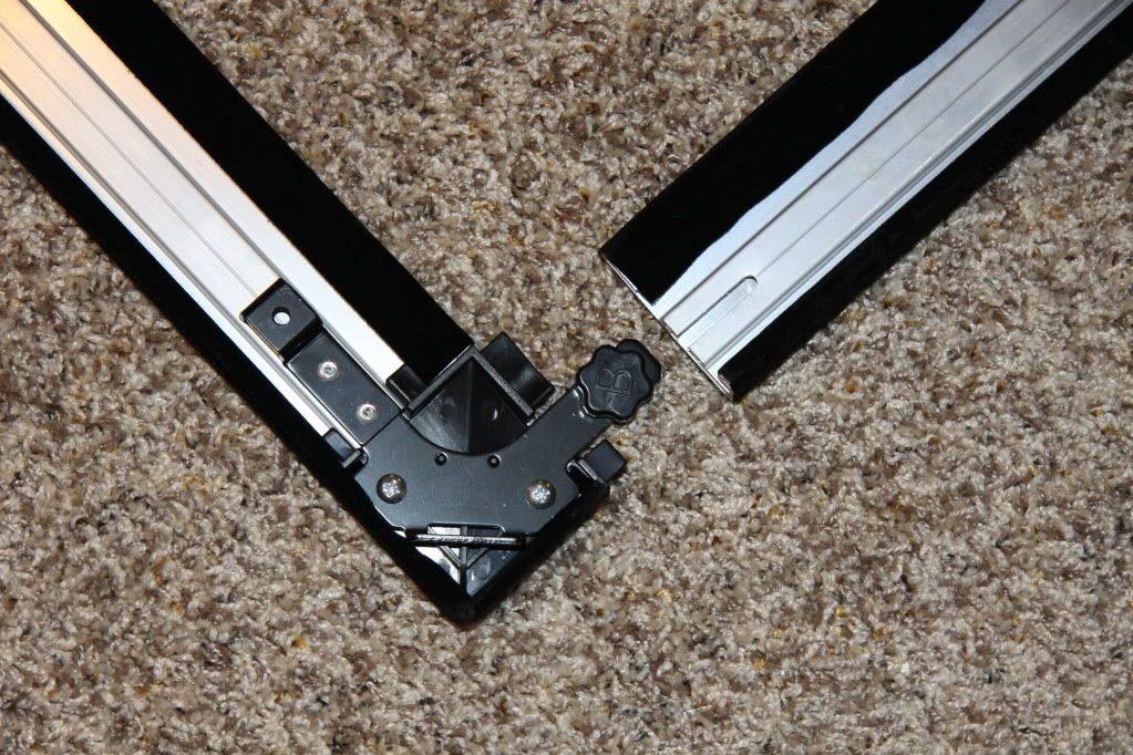

The HT screen is made of Extruded Aluminum which is covered in a black velvet. The gage of the screen if quite thick and rigid and appears to be of good quality. There was one very small imperfection on the velvet, but that was on the back of the frame and can not be seen from the front, other then that I was quite impressed with the quality of the framing materials and workmanship. The frame is designed to slide together and lock into place by some cool and well designed corner clips.
The clip is mechanically attached on the one corner, and the other corner has a thumb screw that you just screw out a bit and slide together. It went together easily once I turned back the thumbscrews and slid into place.

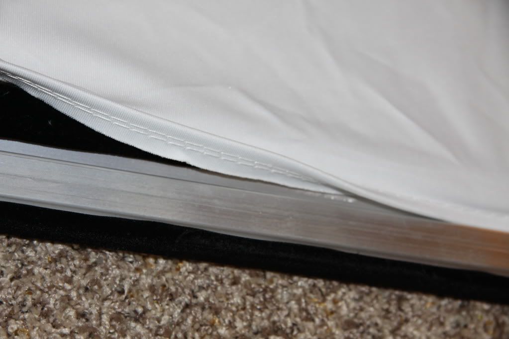

To attach the screen to the frame you need to insert the plastic strip under the inner lip of the aluminum frame. I would insert about a foot of it at a time, then take my thumb or finger and run it over the seam and it would help to tuck it up and inside the lip and lay it flat against the frame. Just make sure your hands are clean during the frame install, its best not to attach the screen after you have eaten popcorn from a different online site, a review to follow on that later!!
Here I have attached one edge of the screen at this point and made sure the Velcro straps on this side were taught. You will also notice there is a loop of fabric here, again not sure what it was/is used for, but it was useful when I wanted to remove the screen from the frame because it was not going in the way I wanted it to. I tried at this point to go to the right side of the frame and pull, stretch the fabric out and continue like I had done on the previous side. This did not work well as I was unable to both stretch the material and install it on the frame. What I did do is shown on the next picture.
