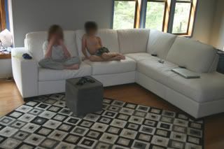

Contemporary style house, vaulted ceilings (~20'). Living room is ~20x23'. Hardwood floors, etc. This picture is of before we started doing any work to it.

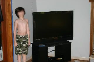

TV in the corner it's going to live in (ya...i know Vizio is a cheap brand...but i like it and it was all i could afford...also, the stand will most likely get replaced at some point).
And looking from the TV outwards:
