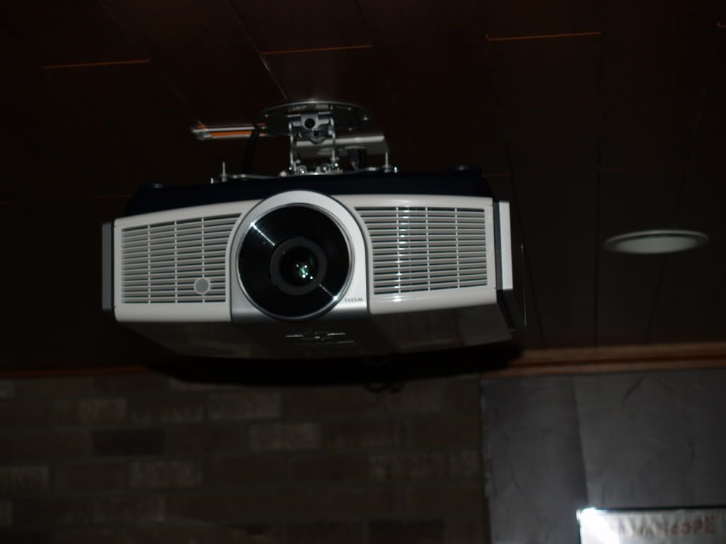

When the box showed up at the door I was amazed at how big it was. Turns out that they packed the actual pj in it's original box within this box. :dizzy: Opening up the pj box I was again amazed at how large this pj was. It was over double the size of my HC3000. Needless to say, hooking it up required a run to the local Best Buy to pick up a new mount. After hooking it up and running it the first time (1 hour on the bulb from the service center by the way), I was yet again amazed at the image it was capable of. I had thought that I had seen enough with my HC3000 that nothing could be that much better.

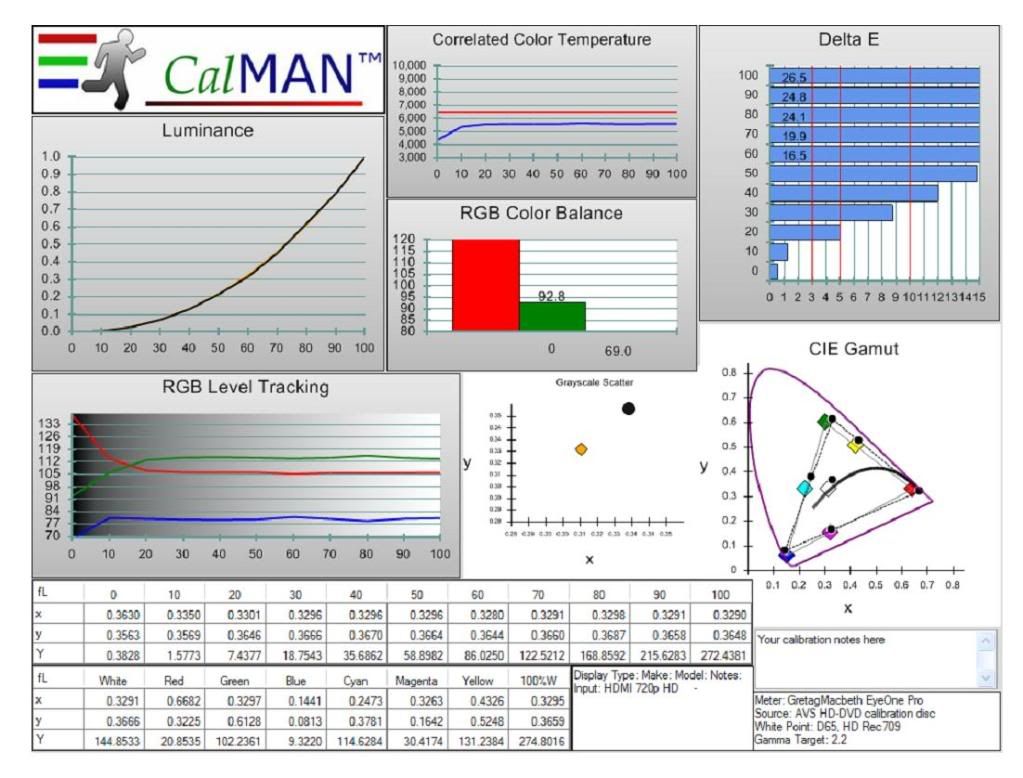

These first four sets of readings are the 'out of box' readings on certain factory pre-set modes. The spectro was ~2 feet from the pj lens, facing the pj.
1 - 20 of 58 Posts
Cinema Mode
Cinema Mode - out of box
***Take note that for these readings I had the meter set up ~10 feet from the pj. The others had the meter ~2 feet.***
That's why these Y values are a bit lower. I took readings closer, but the pdf report was empty. I'll have to see if I can rebuild it later.
I'll reserve my comments on this mode until I have a chance to rebuild the closer readings.

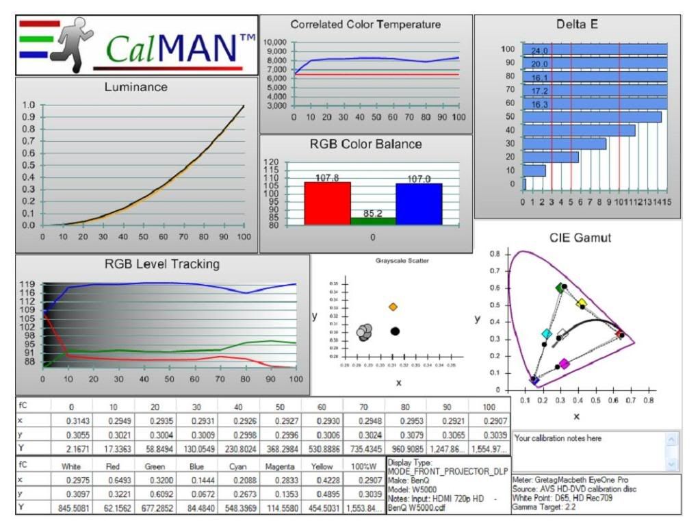

Dynamic Mode
Dynamic Mode - out of box
This mode was extremely blue. Not recommended! By the way the RGB color balance chart is off a bit as my eye-one pro spectrophotmeter doesn't get decent readings at 0 and 10 IRE. And for some reason that throws that whole chart off. If there were a way to not include that chart, it wouldn't be there.

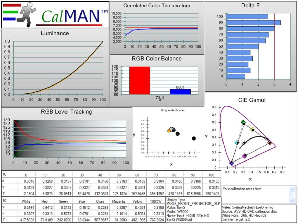

User 1 mode (Warm color temp) - out of box
Someone at AVS had recommended these settings. User1 with 'warm' color temp selected.
Of all the modes out of the box, this one is probably the closest to D65.

So that was three days or so ago and countless hours lost in the basement theater staring at gray scale windows and 75% windows of the primaries and the secondaries. This morning I had time to do some work on black and white levels as well as the gray scale. I also came up with a better way to mount my spectro on my tripod which puts it 1 foot further back - ~3 feet. So here's where I stand right now:
Still needs a tad more work on the white level but at least my gray scale is more in line and I'm pretty much D65 across the board.
I'm gonna work on the Gamut tonight. I've been having issues with green not lining up properly the last few days. But I've got some new ideas to try out.
