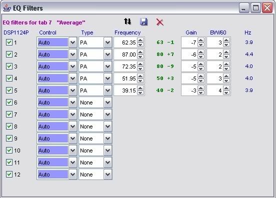

I measured with REW in 6 positions (same used for Audyssey setup) and the Averaged and REW provided following Filters.
I started manually setting filters to Preset 10 (as BFD will be switched on/off by a Power Conditioner)
On FILTER 1 Iused
FINE = -2
BANDWIDTH = 4
GAIN = -3
Then pressed STORE STORE
When I go in FILTER 2 and press FREQUENCY the display shows .50 but am unable to change it with the jog dial.
What am I doing wrong?

I have been able to set filters on preset 5. Not sure why preset 10 is not working. Only thing I see different is on present 10 all the Red LED's are flashing (except the LED for filter 1 whigh was programed).
With Preset 5 only the filters that are programmed are lit.
Also how do you erase a filter?
Cheers,
Mark
Set the gain to zero and save for each filter.
Try changing the filter mode to PA, it sounds like its on SS at the moment.
Hakka.
