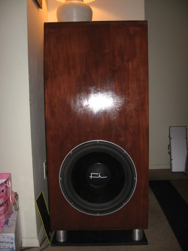

18" Sub, 15 cubic feet with the down firing power port tuned to 15Hz :)
Sorry no construction pics..but here's the finished product. Used a rosewood stain and a Sikkens clear on it...I think it turned out nice for some $2 per sheet birch :D :). Huge thanks to Dave and Ramos for the help! Greatly appreciated :D
The sub is still dirty..haven't cleaned it off yet. I'll get around to it eventually.
-Nick

No pics of the powerport construction!? =Fail:nono:.
Seriously though, what size port and flaring did you go with? 8" er? I'm gonna guess it's a Q18. Whatcha powering Ole Bettsy with? I like the legs...
Yeah went with a 8" one, 2" center and flared down
Just used rings and bondo-glass and made a wiper, sanded it down.
It's not perfect, but I don't have a wood lathe here so it works :)
