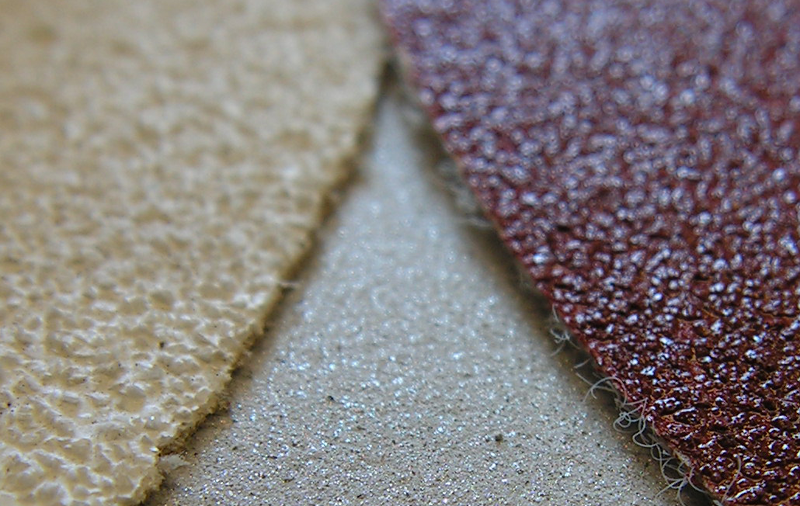

As for the paint being rough, it can't really be called that unless comparing it to a glass-smooth surface. I did a test today (photo below) and you really can't use sandpaper grits to compare screen surfaces. I was wrong to compare BW HE558 to 120 grit, as you can see from the photo. To make long short, BW is not the cause of the texture on your screen; I sincerely think it's the BOC itself, or it's reaction to being painted with the primer.
In the macro photo below, the total width of the image is about 3/4 inch. The cream-colored material on the left is 60 grit sandpaper, the dark rust-colored material on the right is 120 grit sandpaper, the gray area is BW Winter Mist/HE558 5:1. Lighting was overhead fluorescents and a bright L.E.D. flashlight at a low angle from the top of the picture. Only the bottom area of the photo is in focus, but the grain-size of the sandpaper and BW can be seen. The aluminum flakes in the BW are very apparent, and in the area in focus, little black grains of the asphalt can be seen. This is a VERY close-up photo folks. :bigsmile:
