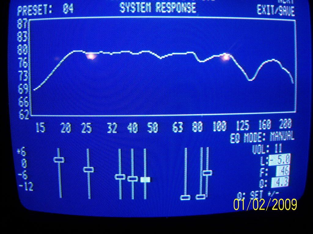

Speaking of the SMS, according to one of our Shack members you really can’t get accurate equalizing from it without using REW and entering filters manually. If you have to go to that trouble, there’s no reason not to go with a BFD. It’s cheaper, to boot. If you’re set on the automated route, it appears the Antimode or SVS-AE1 are better options for the money.
I used to own the SMS-1 and I can tell you that it's not as simple as just flattening the response with filters. They don't tell you that in the manual though. :D
Creating a flat response is not good enough. One can create 10 flat curves and still have completely different sounding results every time. With my SMS-1, a flat graph equated to boomy, sloppy sounding bass and I never understood at the time why that was the case. Surely I should be getting nice tight, responsive bass, right ? Well, no, not really, although the level of bass had been reduced, the filters that were applied did not target the mode center frequencies with enough precision and the display of the SMS-1 was not accurate enough, in my opinion, to deal with those issues.
Like the other poster mentioned, it's essential that you use REW to input filters and see the results as the SMS-1 display is not reliable, in my opinion. So for now, it looks like the Anti-mode is the best (and most affordable and easiest to use ) automatic EQ on the planet. :)
