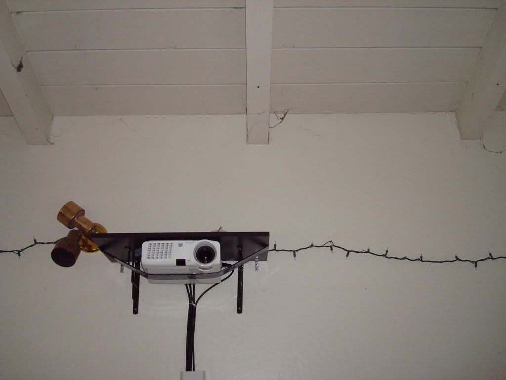

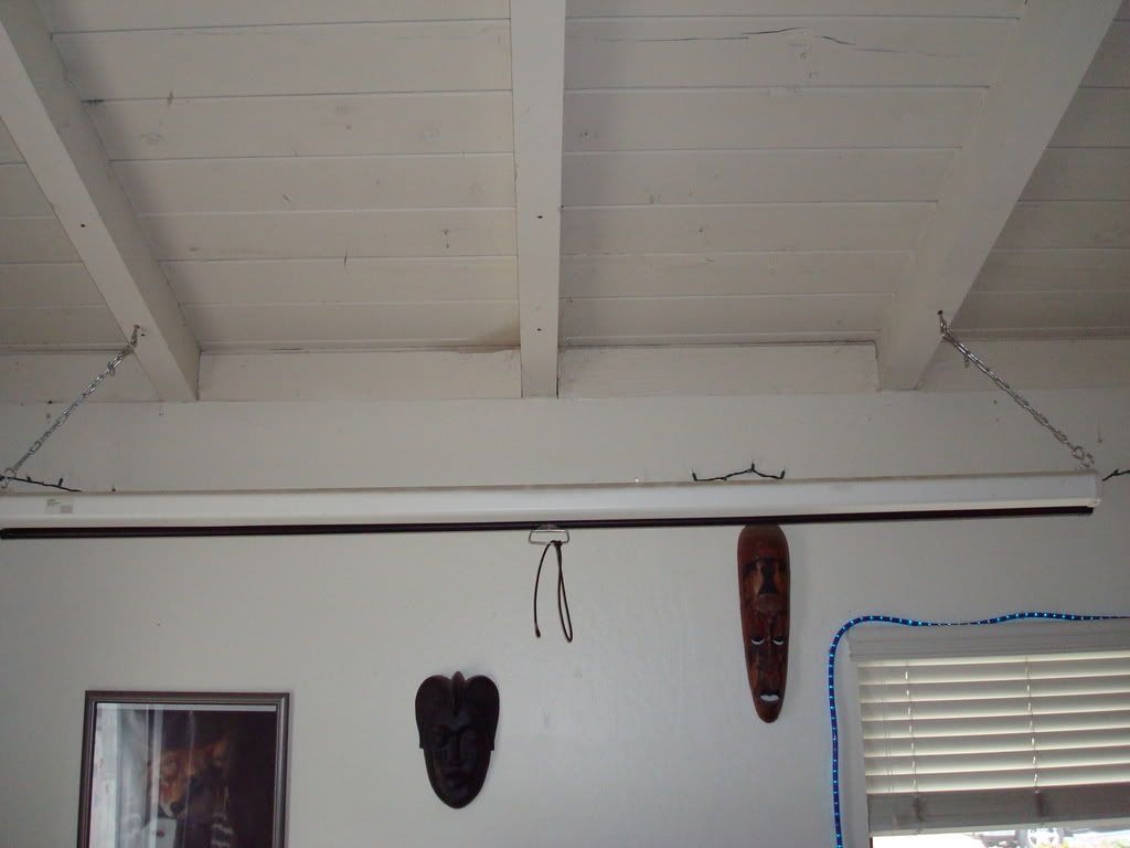

I have an optoma HD70 and i need a celing mount. Here are some pics and as you can see i missed the center by about 1 foot. I need a mount that can adjust down about 2 to 3 feet. I have looked and can not find a mount that extends more than a foot. As you can see the center beam on the ceiling is perfectly in the center of the screen so i need a mount that can mount on the beam on the projector side. Because i missed the mark the image is keystoned pretty bad. I can move the shelf over a foot but since i need to move it why not just buy a mount. (to put on that beam)

Yes that would work but the sheet rock is really thin because this room is an ad-on. This is why i am trying to mount on the beam on the ceiling. Thank you for your response.

IIRC, Parts Express had a projector mount (might have been a Sanus) that you could use threaded steel pipe for an extender. Then you could just mount the top with a flange (for the pipe) and use the bottom part of the mount for the projector.
Alternatively, you could just use your existing setup and two pipe flanges to mount. The downside there is adjustability. Be sure to design something that allows you to adjust four screws to get the balance and pitch correct.
3,374 Posts
Well check out the other options on that site. I did notice some 2' to 4' extensions when I was browsing through.
