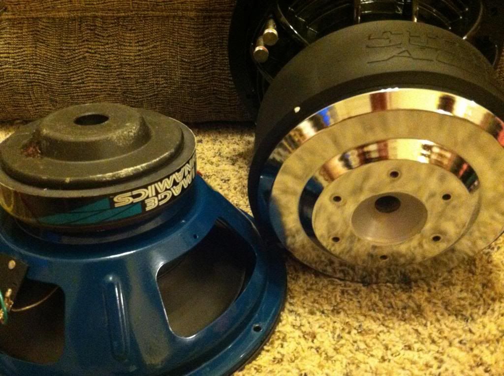

I just got two brand new 12 inch Sundown Audio Zv.4 subwoofers. I wanted to compare them against the many other subwoofers I have in my collection. The Zv.4 is the biggest sub I’ve ever seen in person.
Here is the Sundown against the first subwoofer I ever bought, the Image Dynamics IDQ v2. I’ve put this thing through hell and back and it’s still one of the best sounding subs I’ve ever heard.
