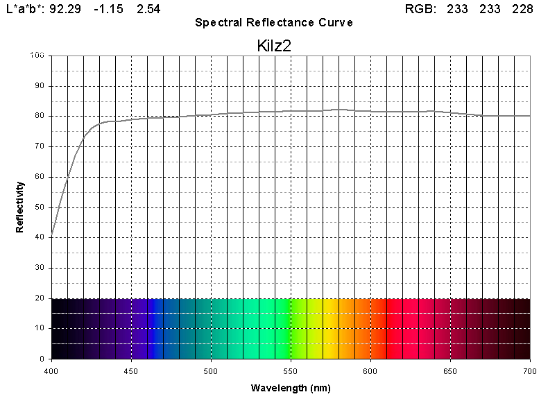

A Spectral Chart of Cream&Sugar. Note that the fancy name isn't used in the chart. This mix has not been color-corrected to make it neutral, it is a simple two-part mix. Of special note is that the L* value in the top-left of the chart is 90.31, this equates to a Munsell Gray of N9; a pure white would be 100 or N10. The a* and b* values are under 1.0 (+ or - doesn't matter) so the mix is considered neutral.
Since C&S will be compared to a Kilz2 panel, I have included a Spectral Chart of my batch of Kliz2 as well. you can see that Kilz2 is brighter than C&S with a L* value of 92.29, the other values show my batch of Kilz2 wasn't neutral (but close enough for gov'ment work :)).

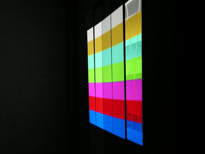

Color Bars at 45 degrees.
Color Bars at about 170 degrees. Sorry, I was in a hurry and forgot to take a white image at this angle. :doh:
While I don't have the photos to prove it, the C&S panel had slightly deeper blacks than the Kilz2 panel. Of course, they were much lighter than the BW panels, but we're not counting those this time. :) I didn't have the disk that contained the gray-scale photo I use, so I had to make do with what I had. :huh:

When selecting a white paint to be used as the base for a C&S mix, look for one that is very "warm", meaning one that is high in the red/orange area of the spectrum. In fact, try to find one that is close to the RGB values of Sherwin-Williams Luminous White. It's RGB value is 247-246-240.
It turns out that I was wrong about LW, I thought it was just another "typical white paint", the fact is it is a very bright and warm white. I have mixed small samples of other white paints I have with the CSMS and the results are not as good as with the LW; the other whites tend to make mixes that push toward blue. It's only a subtle difference, but it's all about subtleties isn't it?
I'll post some Spectral Charts later to show what I mean.
