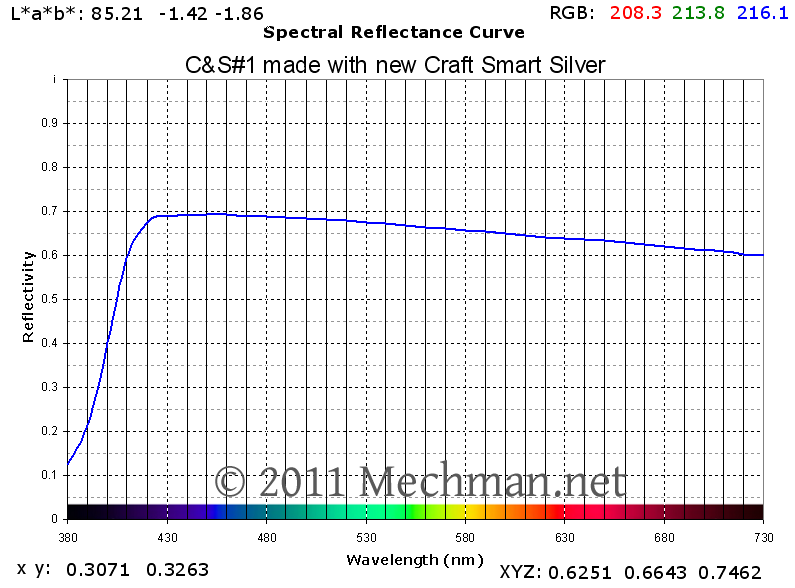

Early tests are showing that C&S™ pushes a bit blue with the new Craft Smart Silver, but this is using the C&S™#3 formula. I'll do more testing with the Sherwin-Williams base like you used ( C&S™#1) and let you know.
Don't be overly concerned even if you have a slight blue push with this mix. While the C&S™#3 test I did was outside of our exacting neutrality criteria, it is still way more neutral than Goo Systems (a commercial screen paint) gray offerings, and many of the commercial gray screens.
The "problem" with the new Craft Smart Silver is that the paint seems to have some real aluminum in it rather than being an aluminum coated polyester flake like the old CSMS. Real elemental aluminum particles are great, but they darken whatever mix they are in and give it a blueish push that must be compensated for by using a colored base like Black Widow™. This darkening effect is why we don't use the aluminum paint used to make BW™ to make C&S™.

The tests are in for C&S™ made with the new Craft Smart Silver, and they aren't good. With the new paint the mixes are too high in the blue and green portions of the spectrum to meet our neutrality standards. We CANNOT recommend using the new Craft Smart Silver to make C&S™. Those that are thinking about making a C&S™ screen in the near-future should search the Michael's stores that are available to them to obtain the older Craft Smart Metallic Silver while it is yet available. A new formulation for making C&S™ is in the works and will be published shortly.
People that have used the new silver paint to make their C&S™ screens don't need to repaint them if they are happy with them; the mix works fine, but it will push blue a bit, but it's not as far off-color as some commercial gray screens or commercial screen mixes.
