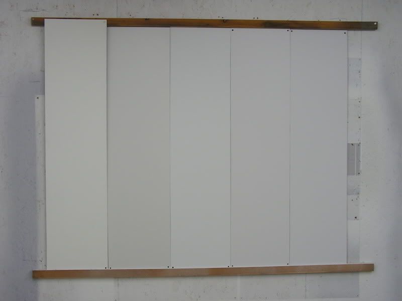

I took some photos of the test panels of the three C&S mixes plus a panel of RS-MaxxMudd-LL.
The panels are, from Left to Right:
1. Kilz2
2. RS-MaxxMudd-LL
3. C&S #1
4. C&S #2
5. C&S #3
I'll give a C&S formula summery at the end of the post.

The first photo was taken with flash on the auto setting
The first panel is the lightest (Kilz2) and the second is the darkest (RS-MM-LL). This is what the spectro results show as well. The RS-MM-LL panel doesn't hot-spot under camera flash.

Summation
The best Cream&Sugar mix seems to be the original C&S #1. The main reason to use the other C&S mixes would be to save money by not having to buy a full gallon of the base paint.
Currently, C&S #1 and C&S #3 must be made with specific base paints. C&S #2 can be made with Behr UPW and Lowe's Valspar Ultra White paints, also it can be made with either the plain flat latex or flat latex enamels in those brands. I suspect most bright white interior house paints would work as well.
I can't recommend RS-MaxxMudd-LL for what I hope are obvious reasons. I do think that with a little tweaking to fix hot-spotting (and leaving out the gold ;)) this mix could be a contender.

Re: Cream&Sugar - an N9 reflective screen mix.
Don,
:clap:
Nice job! It turned out as I suspected it would. I promise I'm gonna get this up in the stickies today! :T
The RS mix hot spots and appears to have an awful viewing cone. We've always said it was because of the cheap mica but I think you've proven us wrong with C&S!
Very interesting and very comprehensive Harp..:T
I'm very surprised that the RS mix hotspots like that..
Obviously the mix produces some reasonable gain and hence the limited viewing cone..
It looks like you hit the right mix first off, with C&S 1..Which makes it a very simple and effective DIY screen paint..::T:
Well done..:clap:
:thankyou:, one and all. :cowboy:
After pondering a bit, I think the reason C&S #1 works the best is because it has the most visible sparkles in it.
My sample chit of the Valspar enamel tinted to match TV "Refinement" has dried enough so I can take a valid spectro reading. The spectral curve isn't exactly the same as "Refinement", but it is close enough for further testing. In fact, very early tests using it as a base for C&S #3 are good enough that a full test panel will be done. :T
My monitor is old... but to me it looks like Kilz is at a similar grey-level as the C&S mixes. What am I missing? I thought C&S was considered N9 and Kilz was whiter.
How are the black levels by your eyes? Again my monitor is too old for me to tell.
Thanks,
Kilz2 is not the whitest white, but it is a paint that most DIY screen painters have, and is usually what a screen is primed with.
Some "brightness" numbers for white paint (at least my cans of them):
Kilz2 92.29
Ace Hardware Ultra White flat latex 96.47
Sherwin-Williams Luminous White 96.81
Behr UPW #1050 flat latex 97.19
Valspar int. flat Ultra White enamel 97.32
These are the L* values from the L*a*b* measurements. 100 would be 100% white and 0 100% black. In the real world those top and bottom values are never achieved. The L* value is also very close to what the Munsell N value for the color would be, so close as to be interchangeable for most purposes.
The same value from the C&S mixes are:
C&S #1 90.31
C&S #2 88.38
C&S #3 89.04
It's interesting that I didn't notice this before, but C&S #3 should be visibly brighter than C&S #2, but yet the opposite is shown under PJ light. I attribute this to the sheen from the enamel used to make C&S #2 and/or perhaps the base paint of C&S #3 was muting the reflective qualities of the metallic silver more.
As for laminates recommended for white screens:
Wilsonart Designer White 93.3
Parkland Plastics Polywall 93.4
I don't know what your Do-Able is.
To answer your question :bigsmile:, while Kilz2 is brighter than the C&S mixes, it's not a lot brighter. The C&S mixes are also quite a bit more neutral than Kilz2.
My general understanding of screens is that the brighter white the screen is, the more any ambient light, or even PJ light reflected back onto the screen from ceiling and walls, causes problems.
Thanks,
Funny you should ask. :bigsmile: I was watching some movies on the composite white screen I used for my post and played scenes from a number of different movies. My general thought was "Wow, this white screen stuff isn't so bad.", but then I played a movie I've taken screenies of before ("The Fifth Element") and I didn't watch it long before I was saying to myself "Where the **** did the colors go?". I tried adjusting the PJ and nothing I could do made the picture look like I remembered it under a gray screen.
I would say that the contrast level (range between white and black) was about the same for the white screens. I didn't find myself going "Where are the blacks?", but instead, the whole image lacked "snap" for want of a better word.
I still consider myself to be new at this PJ stuff, so I hesitate to make a recommendation of screen type for others, but as for me; I'm a gray screen man! :cowboy:
BTW, I'm going to be doing another thread called "Why "screenies" don't matter" soon using photos I took from the above white screen.
