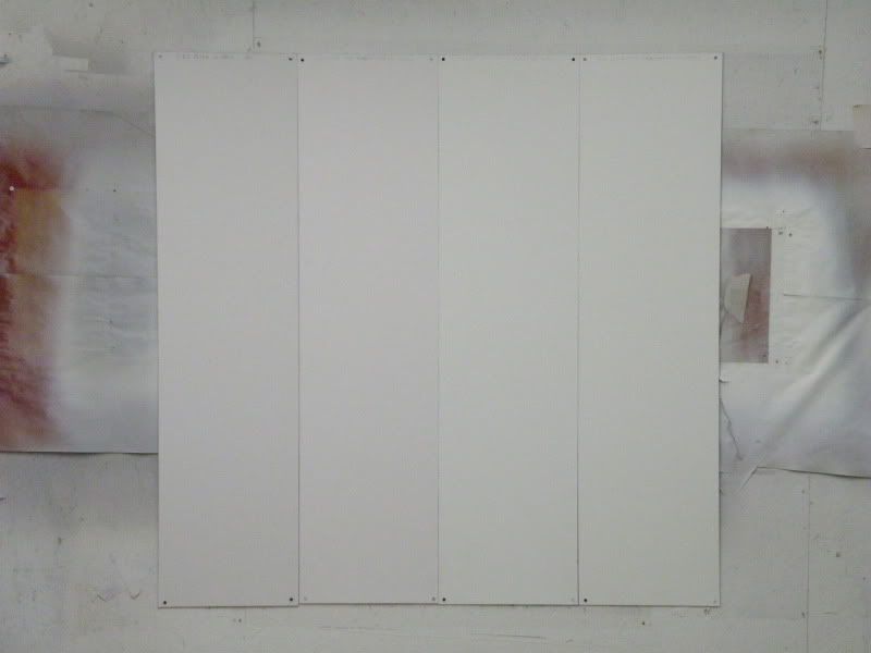

Here are some photos of C&S Ultra compared to Sherwin-Williams 'Extra White' paints in satin finish. This composite screen consists of four 1'x4' panels. They are displayed on the wall where I painted them. These aren't "eye candy" shots, but are rather to help demonstrate how these screens actually compare to each other.
The projector used is a Viewsonic PJ503D which is a presentation PJ that has had some firmware tweeks done on it so they could call it a home theater PJ. It isn't. The brightness/contrast/color adjustments on this PJ are about like you would find on an inexpensive 20 year old CRT TV set.
Left to right, the panels in the photos are:
  • C&S™ Ultra made with Valspar Ultra Premium white tinted to produce a neutral C&S™ screen
  • C&S™ Ultra made with Valspar Ultra Premium Enamel ultra white tinted to produce a neutral C&S™ screen (this is the official C&S™ Ultra mix)
  • Sherwin-Williams ProClassic interior acrylic latex 'Extra White' B20 W 51 in satin finish
  • Sherwin-Williams Color to Go (their cheap sample paint) 'Extra White' A91 W 251 in satin finish
All panels were sprayed using an air compressor/HVLP gun combo.
Panels in room light (ceiling mounted fluorescent). You can see the C&S™ Ultra panels are slightly darker than the 'Extra White' panels.
100% White field on-axis. To my eyes, the 2nd panel is brighter than the 3rd panel by a very small margin. The brightest panel is #4 (the cheap Color to Go sample paint $5 a quart).
100% White field ~70° (0° is on-axis). This is about the greatest angle that I would call viewable in a home theater, any greater angle creates too much angular distortion in the image. At this angle the C&S™ panels are darker than the white panels, but not by much. There is no hot spotting from any panel.
Color bars on-axis.
Color bars ~70°.
I would say that of all the paints tested above the SW Color to Go 'Extra White' satin produces the brightest screen. Here are a few photos from the Digital Video Essentials DVD.
Earth. It's hard to tell the panels apart unless you really look close.
Space Shuttle on pad. The thing to look at here is the grass at the bottom of the photo. The 2nd and 4th panels are the brightest.
Ambient light flag. This photo was taken with about 500 watts of "cool white" fluorescent light bouncing around a small room with white walls and ceiling. It's not a watchable image by any stretch of the imagination, but it shows the ability of even a light gray screen (the C&S Ultra) to boost black levels and color saturation over a white screen. The projected image (100% white field) has a measured brightness of 27 fL, the room light at the screen was measured at 24 fL.
