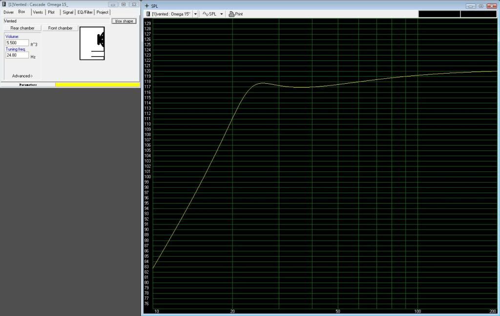

15" Cascade Design Omega playing with WinISD right now. Guessing around 5 cu.ft tuned to 26hz with 2 4" vents? I'm pretty open to box size I have plenty of room. The box just has to fit through a door and up stairs.
Sub is 2000 RMS 4000 max. This is what I came up with and how do I post A project file? That is with two 4" ports.
Save the project you are modeling in WinISD, then upload it here.
I saved it On WinISD and when I go to search for it where the driver's list is it isn't there. But when I start the program I can find it in there. I'm not too sure how to make that work. but these are the parameters you help me find on Steve Mede's page.

when I go to Winisd it doesn't have a projects folder only Driver and crossover. I have to be dumb. Let me look through it again. I go to program files. Linearteam-winisd-that's where it ends and I can't find a projects folder but it is there in the program itself. when I open WinISD and open project it shows the file being there with Drivers and crossovers. But when I go there through Program files it dosn't exists. and I can't copy it from the program and drag it to the desktop. Its quite fustrating.
I saved it. so its under projects through the program. but when I search for it through program files the Projects folder isn't there. I don't know if its because I have window's Vista or if I'm lacking intelligence to do a simple task lol.
