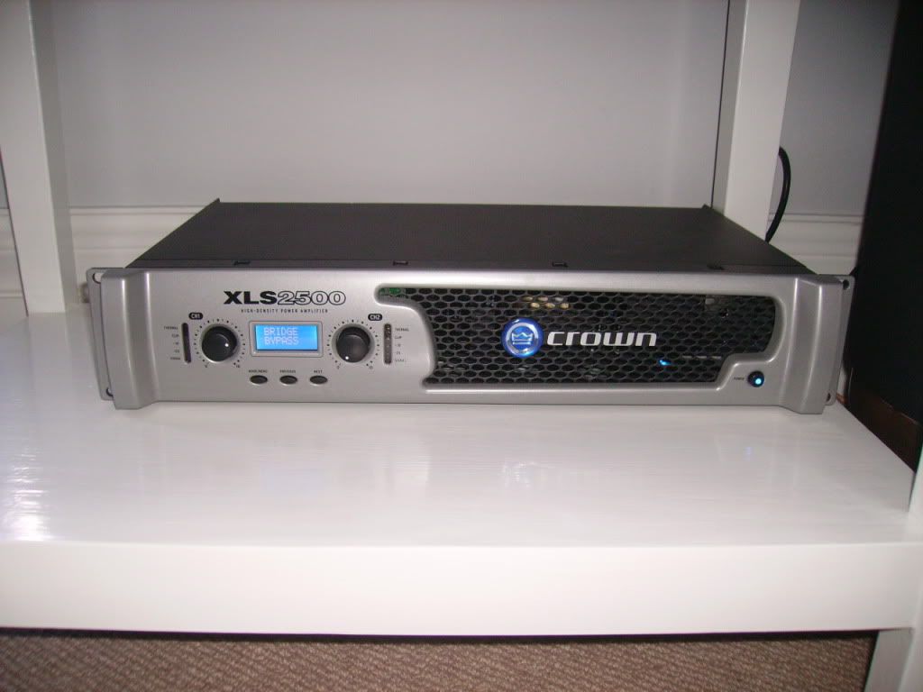

Hi guys I'm looking at buying an amp tomorrow and at the moment I'm looking at a crown xls2500, I want a one unit affair and crown make one of the best sounding and reliable amps. Plus it looks the conkers!
I only need it to drop to 20hz plus it has a built in hpf and lpf with lots of other nice features. I'll be pairing with a pioneer sc-lx83, will I need a seperate EQ?
I got the following specs from the manual, are they any good?
Forgot to say its for my DIY re xxx subwoofer.

I purchased the xls1000 to run bridged to my sub. I really like the amp, but there are two things to consider.
I ran into a voltage issue between my receiver and the amp. The amp is looking for 1.4V so if your receiver doesn't put that out you will not be taking advantage of the amp.
The second thing is that you probably won't use any of the filters built in. If you cross over with your other speakers with the subwoofer it will be through the receiver.
But I really like the amp. I have no problems with it getting hot, or fans running loud, which I hear a lot of with behringer amps. I also like that it has RCA in which most pro amps don't have.

Thanks fwiler, I've ordered the amp and as they say the proof is in the pudding! Just have to be patient untill it gets here now. :whistling:
162 Posts
I second what Fwiler said. I have an XLS 2000. My receiver could not produce enough signal for the amp so I had to purchase an Art Cleanbox Pro. This boosted the signal enough so the Crown amp could slam hard.
A plus of the Art Box was it also converted the RCA from my receiver to Balanced (XLS).
