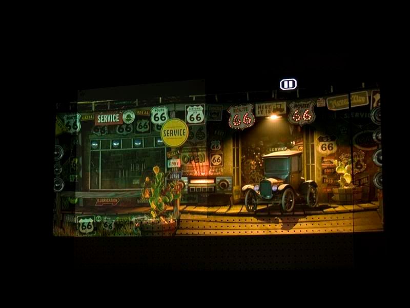

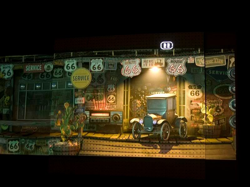

The High Power
2.8 gain - 30 degree viewing angle according to the webpage but the sample sheet states the the 30 viewing angle/cone symbol =
Number shows the optimal width of the ideal viewing cone
These are the shots that will be taken three per image - high ambient, moderate ambient, and no ambient. There will also be an additional six shots per image for some - three at 15 degrees off-axis and three at 30 degrees off axis. Lotsa photos folks!
One other thing to note, There will be no 'Bugs!' shots. I had to take the projector down from the ceiling to do this review as well as move the DVD player. That was enough! :gah: As stated in the descriptions in the first post this is a retro-reflective surface. Don't know what that is? Check out this post. It's in the Gain and other confusing topics thread started by Bill. Why haven't you read that yet?!?!?!?
We'll start off with some space shuttle shots from the DVE Disk. Six shots - three at zero and three at thirty.
Click on each thumbnail for a full size image!

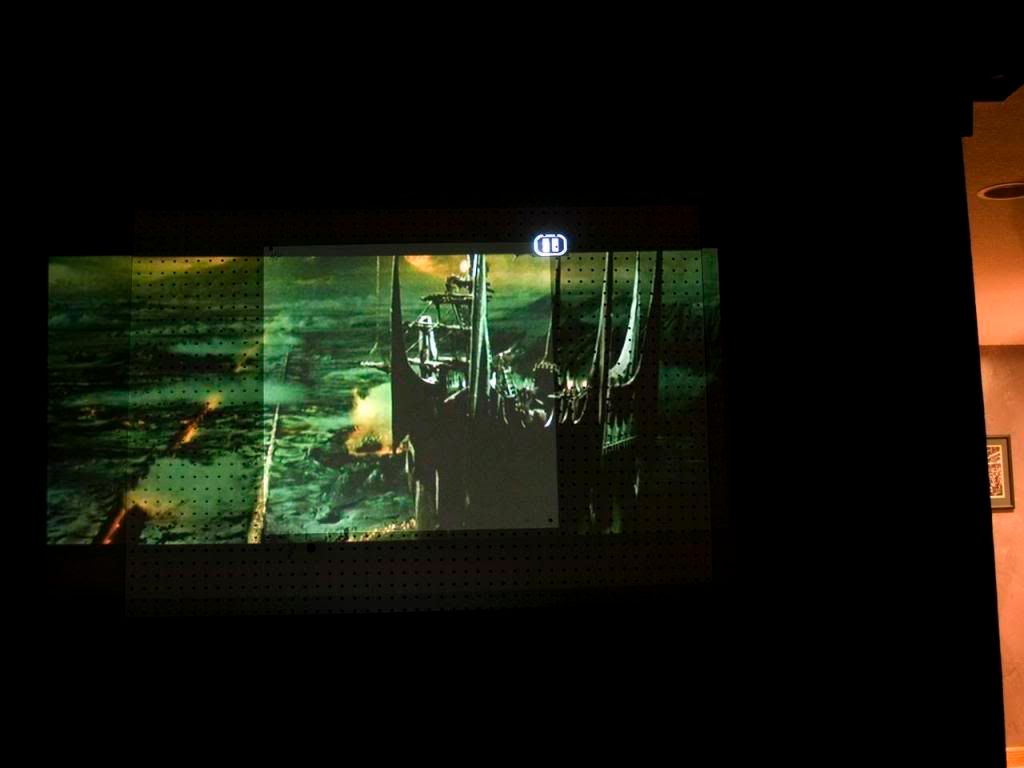

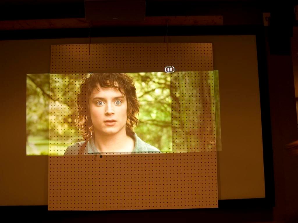

[BANANA]The Da-Lite Shootout!!![/BANANA]

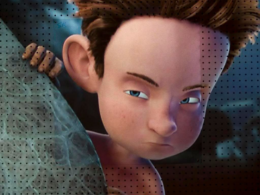

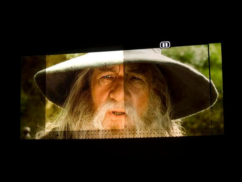

That's right folks it's time for a shootout. One is not sold as a home theater screen and the other is a 'highly' touted home theater screen! I decided to do this because out of all the samples that I've viewed from Da-Lite, the one that really caught my eye was the Silver Matte. It had better whites than the white pegboard behind it and it did a great job in ambient lighting. The problem was, they don't sell it as a home theater screen. Why? I'm not sure and it being a holiday weekend I can't ask until Tuesday. So look for added remarks then.
To take side by side comparison shots of two different colored screens would only do one justice. Therefore I have taken two sets of shots one with the projector's brightness and contrast adjusted for the High Power. And one set with my Fashion Gray settings which appeared to work fine for the Silver Matte when projecting DVE's DVD PLUGE w/gray & bars and the reverse gray ramps. The other main thing to note is that for the High Power shots the projector was setup on a end table to take advantage of the retro reflective properties. And the projector was ceiling mounted for the Silver Matte calibrated shots.
There will be six shots per row. The left three are Silver Matte calibrated images. The right three are High Power calibrated images. They are of close to the same image within a second or so.
30 degrees off axis
15 degrees off axis
On axis
