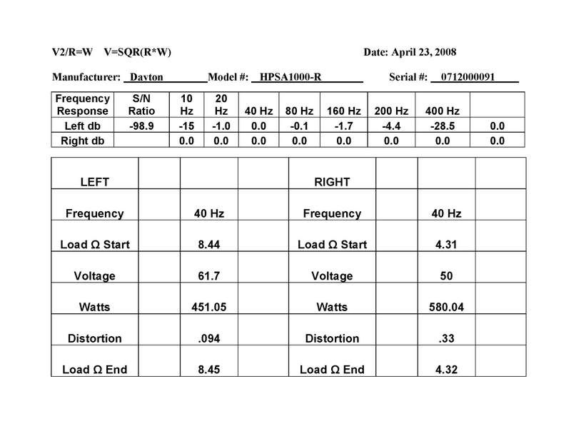

Don't how different the hpsa1000 is but here are some bench test on actual power output.
The HPSA was discontinued and the SA is the newer version.
Found this on another forum.
My hunch is that PE had to change the name and the design slightly because the HPSA-1000 was shown to deliver less than rated power. I believe it was tested to actually deliver about 600W into a 40Hz sine wave. I'm not knocking it, mind. I'm using an HPSA-1000 right now in my nearfield system and it drives a sealed Maelstrom-X just fine.
Note that the SA1000 is listed as ~100W less powerful at 4Ω. I would guess that the amp section is likely the same - they weigh the same - but the rating is closer to reality.
