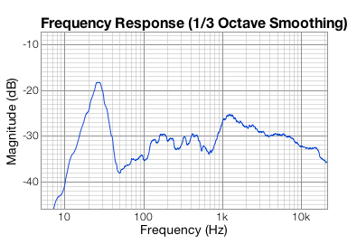

I've got it on good advice to reseal and redampen the cabinet if I get started on this project. The DEQX I think is probably gonna do a bit more than just change the crossover :) I need more EQ and room correction with these speakers than what Audyssey Pro can give :) Have a look
at the native response of the left speaker and
for the right speaker.
