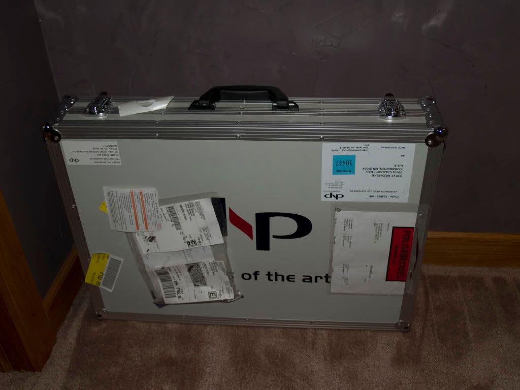

The sample was sent in an aluminum suitcase:
The sample they sent was a XX" size framed mini screen. The frame itself is aluminum with a felt/velvet 1" strip on the outer portion of the screen to absorb light spill. The bottom and left sides of the frame were silver/aluminum in color and the left and top were black. Kind of a neat touch. :T

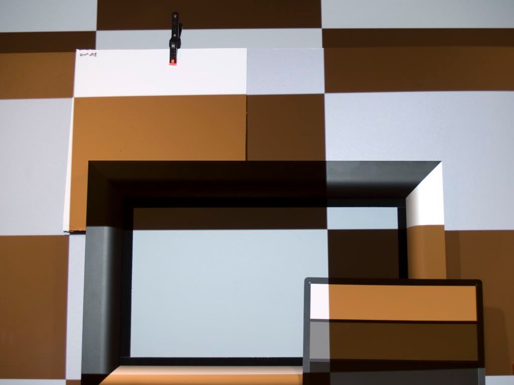

Gain - Gain measured with a 60IRE field was .78 and at 30 degrees it was still at .5. I only did those two readings.
These pictures show you the Supernova's capabilities in high ambient lighting. The background screen is the diy paint mix called Silver Fire with a matte white reference square on the upper left side.
Lights on full
Front can lights off
The Supernova is quite a bit darker than Silver Fire and yet it has equal whites and yet much darker blacks. I'm going to use these pictures in a new discussion thread about something that I've recently become an advocate of - screen noise. Briefly, the Silver Fire panel exhibits a lot of screen noise while both the matte white and the Supernova reflect the image accurately and purely. Look for an upcoming thread on screen noise soon! ;) The Supernova exhibits no screen noise whatsoever.
Keep in mind that this kind of technology does not come cheap. dnp has years of research built into their products and therefore they go for premium prices. One other thing that should be noted is that while the 08-85 screen material is touted as a solution for high ambient light applications, it works equally well in a dedicated home theater, as the contrast filter sets new standards for viewing in a dark room.
