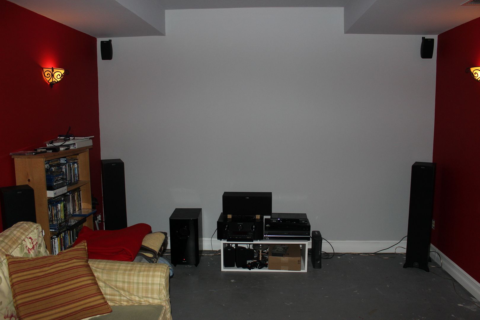

i used the behr premium plus self priming interior flat base 1050 silver screen 770e-2 mixed 9/20/12 and this stuff is as flat as can be. i have noticed zero hot spotting. i have no experience on what a good screen can look like other then in a movie theatre, but after watching TV for decades this looks pretty good to my eyes. admittedly i wanted a quick and easy soloution but now my wife looks at me funny when i talk about buying a real sccreen and says why?

it was new drywall with one coat of behr sealer drywall primer and two coats of the sliver screen...it was base 1050 i could not see 1850 listed any where. i just got up close and personal with the screen looking at it and i can see where a third coat may be necessary in one or two small spots. i cant tell if i missed a spot or since we are now finishing the rest of the drywall we brushed against the flat and scuffed it. we used about 1 quart for 12' x 8' wall. I have watched a lot of movies on this and it has to be really close to a good quality screen.

well heres my 1 year update.....we originally used the Behr silver screen as a quick and easy method to get up and running in the theatre room and really liked it, the boss vetoed black ceilings and a black border around the screen so we decided on a grey and dark red paint scheme. I used the Behr 1050 silver screen paint and the similar product in the red i believe they were both self priming. I really like it and have no plans to change the screen paint. so if you are thinking of a similar paint scheme I can say this combination has worked well for me. I might have painted the screen wall one additional time since my last post as the very last wall we painted.
