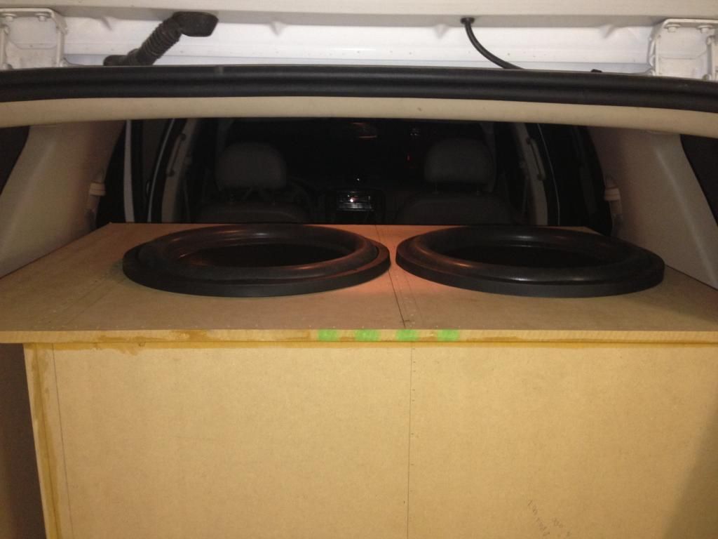

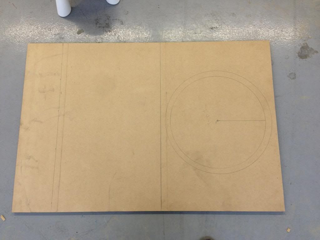

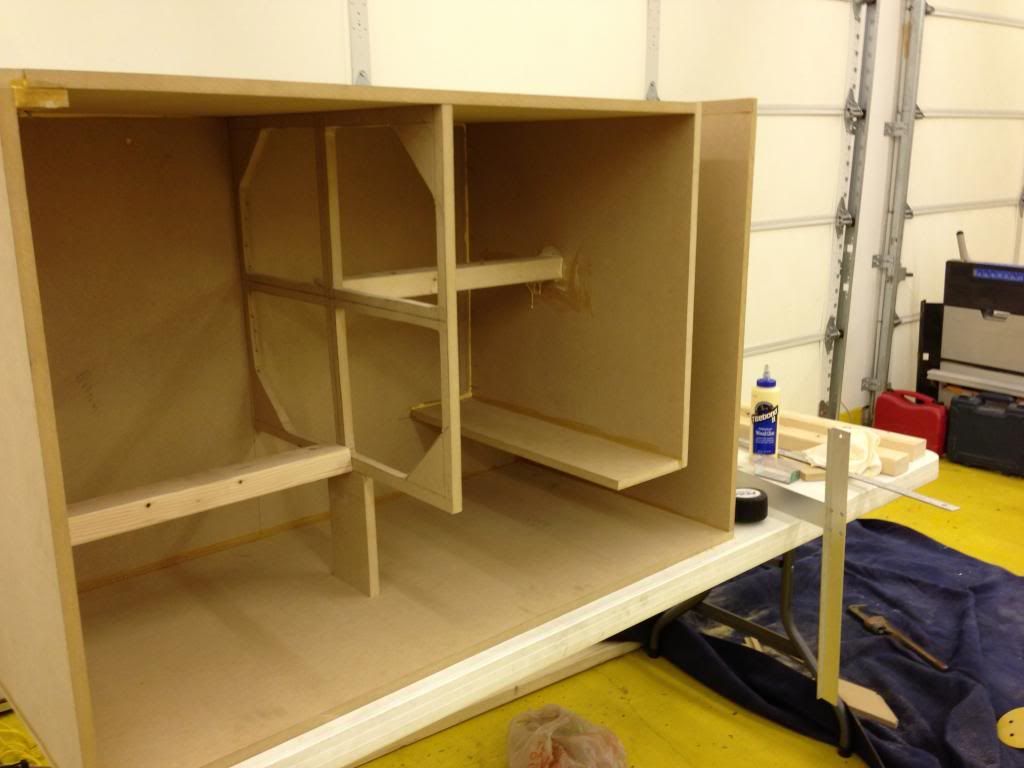

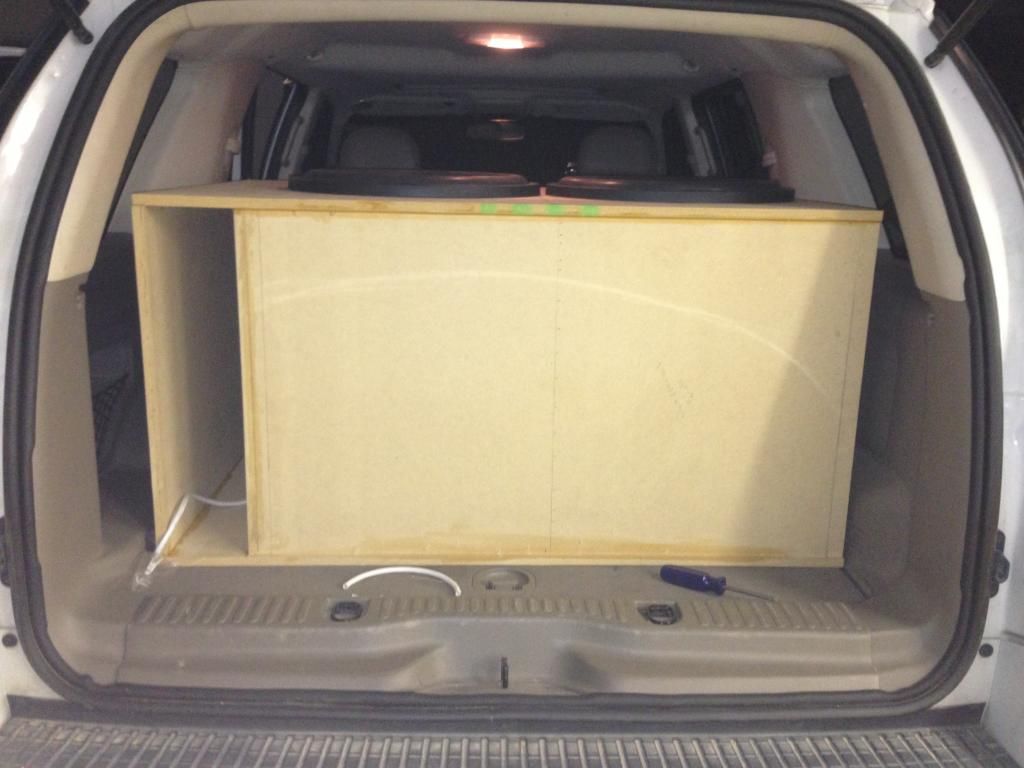

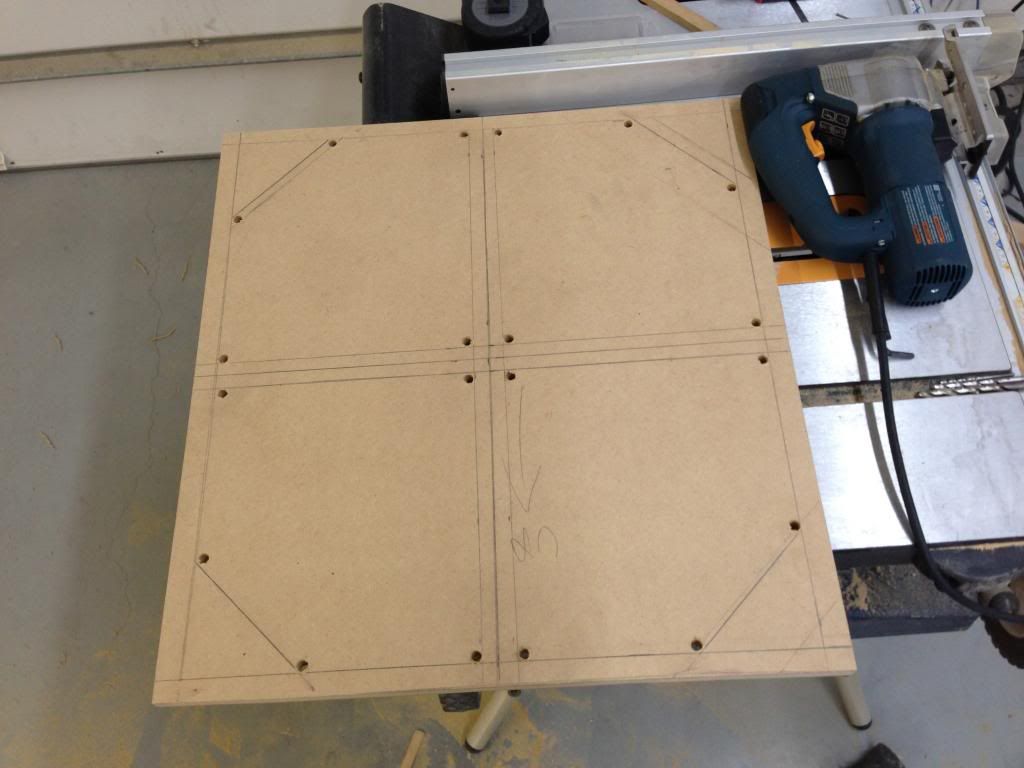

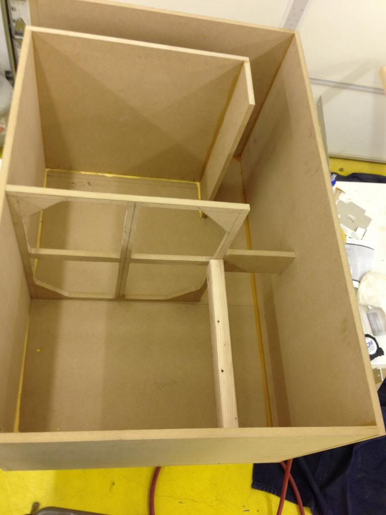

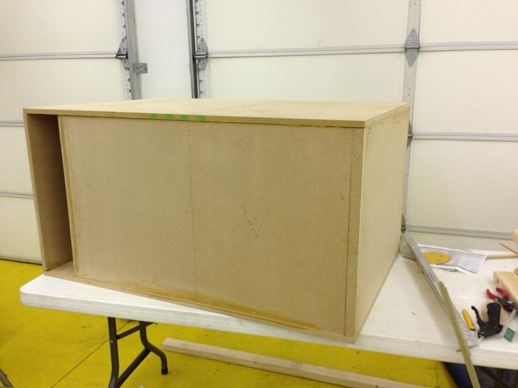

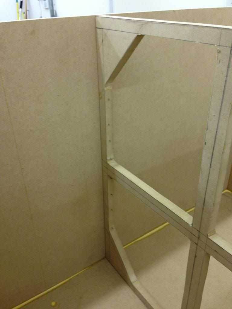

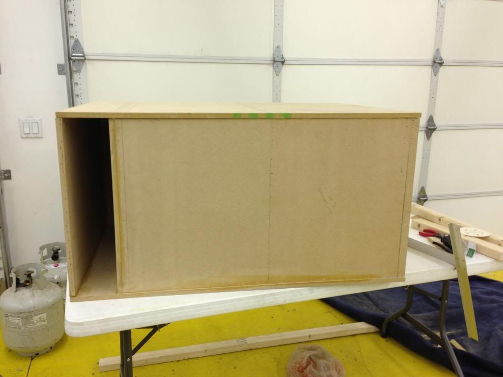

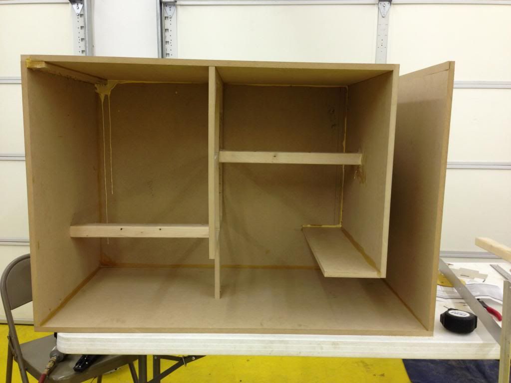

I picked up a pair of fully loaded Q18's about two months ago and just got around to post the build log...between work, being sick, and having my tonsils and adenoids removed yesterday morning, I've had almost no free time. Good thing I had the box completed before I picked up the subs! Anyways, I decided to throw these in my explorer at first while I'm changing the motor in my nova so for the time I just have the Q15 in my room.
The box the 18's are in now is 13cu.ft tuned to 24hz, dimensions are 44.5"x30"x22". Just decided to do a simple slot port. Had to have Lowe's do the cuts as I didn't trust the table saw I had access to at my house; it's one of the compact ones. I just had the guy make the cuts around 1/8th" bigger than they needed to be. I'm probably going to build another box once I move these into my room, I'm thinking about doing 20-25cu.ft tuned to 14hz for movies and 25hz for music, granted if I can figure out a way to keep the tune exact for both without one port bleeding over to the other.
Here's the build pics:
I have some videos that I'll upload tomorrow if I get a chance. I definitely know this wasn't one of my best builds, I ran out of material for the bracing as I'm sure you noticed. The person doing the cuts at Lowe's messed up one of them and it forced me to improvise other things for the bracing lol. Even though the bracing looks somewhat sketchy, its actually very solid. There's a lot of pressure being exerted on the outside panels to keep panel flexing to a minimum.

I am sure that system ROCKS. Next build you do for your car though make sure to add lots of bracing and double up on the walls. I dont know exactly the number but I would think you would lose a few dbs because of flexing panels. But your SPL would be loud enough in your car that who really cares about a few DB's. lol
I am sorry you have been sick. Glad your able to give us an update and glad to see things are coming along nicely. Cant imagine dual 18's in my car. Last time I had anything it was three JL 10w6's.
STAY healthy and keep the builds coming. FUNNY thing is your sub cabinet is about the same size as my PA TH I just built. :D

looking good. I wondered at first what was up with the bracing till you mentioned materials. also surprised you didn't double baffle the front with the woofers.
To be honest, doing a double baffle didn't even cross my mind until after I left Lowe's. Kinda wish I had done a double, but the way the port, bracing and walls are set up, I'm actually not getting any movement of the woofer baffle. I glued and nailed the out of the top just for that purpose. I did about 6 passes with tite bond, letting each pass sit for about a day or two. No air leaks at all in this box thankfully.
