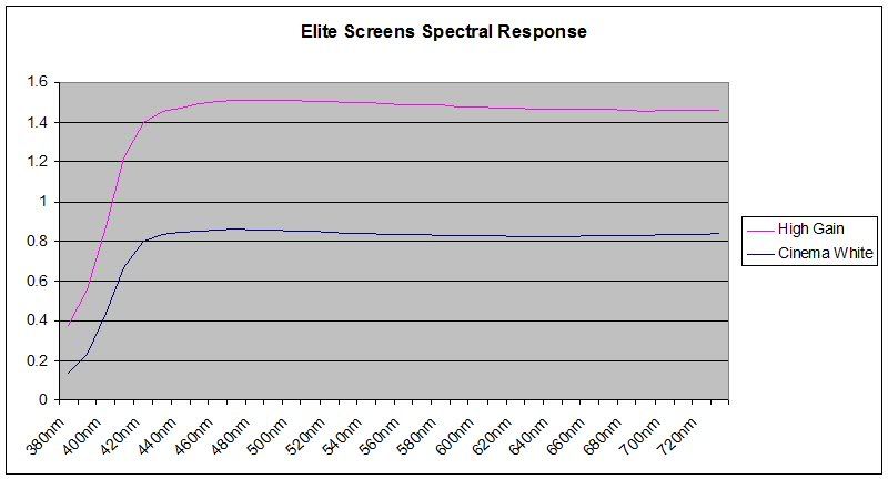

As stated previously, Elite sent me a full size Power Gain screen and they also included a sample of the CineWhite material. I made up a spectral response curve chart for both of these materials:
What's encouraging here is that they are both fairly flat curves. There's a very slight dip on the red side of the spectrum but it's small enough that I consider it insignificant.

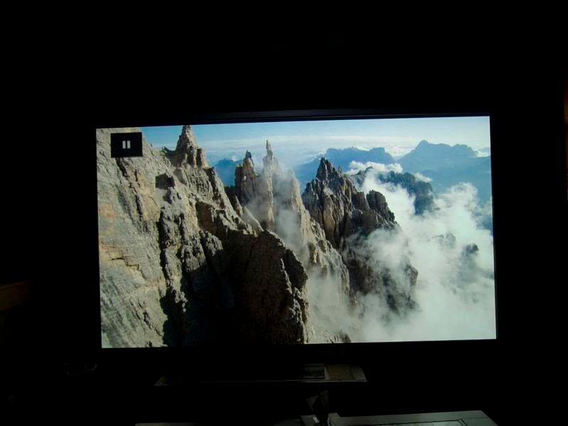

Anyone who knows me or who's been here at the Shack for awhile, knows that I strive for accurate representation when taking screen shots. It's a bit of a painstaking process and I'm sure there are faults. But it's the best that can be achieved with my limited camera knowledge. Most of the investigation of how to achieve accurate color representation when taking screen shots is here. The gist of it is this, I use a WhiBal card (neutral gray reference card) in a shot while projecting white light from my projector. It is my color management shot. I then shoot all of my pictures, in RAW mode. When finished I process the WhiBal shot in Adobe Bridge and apply the settings to all of the screen shots. I've found that this is the most accurate way to get the true color image from screen shots.
I just wish I was as particular about double checking the tripod/camera for being plumb and level! :eek:
Camera
I use an Olympus E-500 DSLR with a Zuiko Digital 14-45mm F3.5-5.6 lens. ISO is set to 100. Shutter speed and aperture are set to auto. It is sset up on a tripod and I use a remote to snap the pictures as to avoid shaking.
Projector
Mitsubishi HC3000U DLP projector. This projector boasts a 4000:1 contrast ratio and 1000 lumens. It is run in economy mode with Brilliant Color off. All of the shots are taken with the projector settings set to project a D65 image. I accomplished these settings utilizing my X-Rite i1pro spectrophotometer mounted to a a tripod upon the beamer mount.

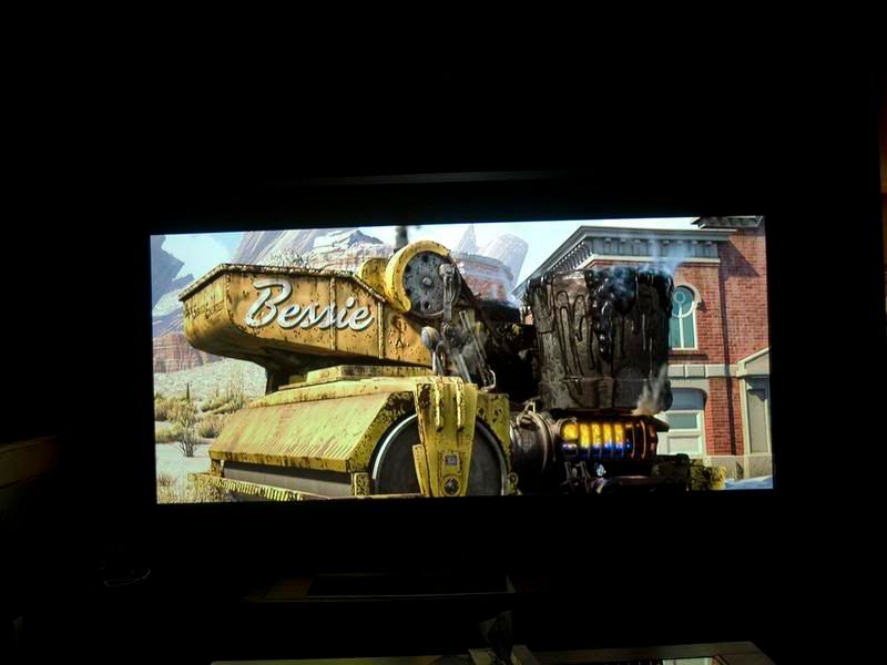

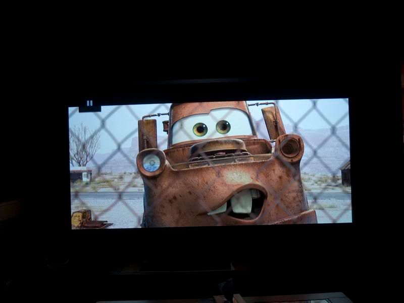

Here are two frames from Serenity. There are three shots of each frame each at a different light level.
Here are the are light readings from my i1pro spectro. It is the nighttime numbers that concern us!

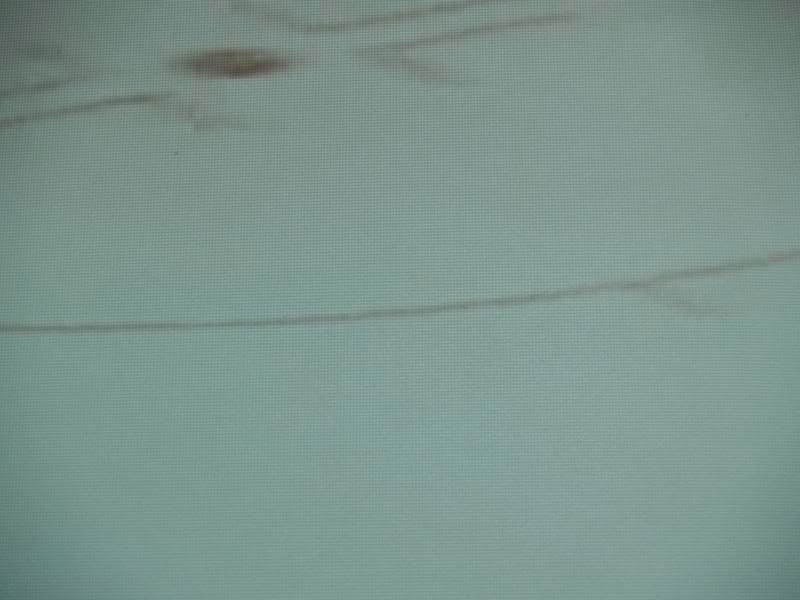

As I said, it performs average with regards to ambient light. The only other thing that I noticed was while watching a hockey game. Most of you know I love hockey so I had to watch a little hockey! ;) I was a bit disappointed with the Power Gain material when it came to something as bright as a hockey game. A grainy texture was easily discernible with the bright white background of the ice.
Here are some shots. Pay no attention to the blurriness as hockey is one of the fastest human propelled sports.
Zoomed in on the left side of the screen:
Compared to the piece of CineWhite Elite sent me:
A little closer:
Closer yet:
You can see in this zoomed in shot that the CineWhite exhibits none of the grainy type image in bright images:
One more comparing the two:
So here's the rub. If you're gonna watch a lot of hockey, I'd recommend the CineWhite. If you're going to use the screen as most folks intend, as a movie theater, get the Power Gain.

Anything that was bright white would reveal the graininess. I don't believe it was a texture issue. And it was the high gain material which is silver/gray. The CineWhite has texture as well but exhibits no graininess in bright white images.
