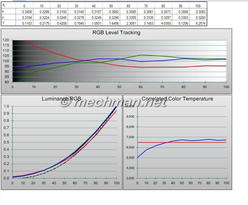

Last night I went to a friend's house to take a look at and put my amateur calibration skills to the test on this particular pj. After spending about an hour or so messing with some of the stock settings to get them close to acceptable, we stumbled upon a factory setting called sRGB. Art at pj review had ignored that setting but we were curious so we took some readings with this setting. I was pleasantly surprised at the results. This is the gray scale run with no adjustments.
The gamut (didn't save the data :wits-end: ) was the best I've seen from the factory in my limited experience. The only thing that we adjusted were the black and white levels. I don't believe any other settings were available for adjustment.
I'll update this when I go back after there are some hours on the bulb. But if you have one of these, I'd suggest sRGB out of the box as a starting point. Keep in mind that all projectors are different and that while this was the 'cat's meow' for us, it may not be for you. :T
