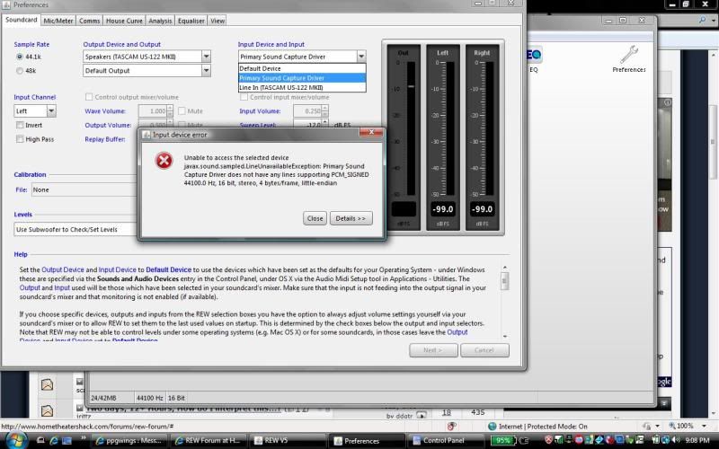

Try, selecting "Line In ( Tascam US-122MXII )" within the REW preferences window as your input choice .
Also, select your Tascam sound card within the windows audio control panel to make it your default card .
<> cheers

It is set that way. In the screenshot I was selecting the other option but I get the same error eitherway. Could this be something with the soundcard driver?

Might be . ( Almost seems that the PC is trying to access Mac soundcard drivers ) .
Try uninstalling those drivers and then reinstalling them .

After reinstalling the drivers and restarting right away it seems to work now. I went through the calibration process. Heres a screenshot of a loopback measurement before and after the calibration. Shouldnt the after be perfectly flat?
- Glad you're making progress . Thanks for the pic .
- Yes, after a successful soundcard calibration / if you take a loopback measurement you should now see a straight line as your latest measurement ( assuming the new S-C calibration is actually loaded / which happens automatically upon saving the S-C calibration file / & assuming you haven't engaged a "Mic/Meter Calibration file " ).
- In your pic, the displayed trace, is the reciprocal curve of your microphones calibration file .
- You need to "turnoff" the test mics calibration file ( since the mic isn't being used here ) .
- Do another sweep of the loopback , after turning off your "Mic/Meter Calibration file" ( in the "preferences window" - second tab ) .
- You should now get a straight line ( assuming you saved & loaded a good calibration file for your soundcard ) .
<> cheers

Oh yea! thanks, I turned the mic cal off and its perfectly straight now.
