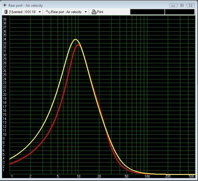

I plotted both in winisd and the XXX gets its handed to it. Ive been in love with the XXX since before it was finished... I know all about it, but I also know the MX, and I know how to plot.
red is XXX
yellow is maelstrom x
xxx vs mx port gain pic, the XXX gets MUCH more gain from the port
SPL pic, the XXX gets STOMPED, the MX is identical from 10Hz-27Hz, below 10Hz the MX gains 2dB, and above... LOLZ! are ya kidding me?
transfer function, only one lookin good for the XXX for my tastes, but NOT anyone elses... I love an exagerated low end hump, vs the normal flat responce the MX shows ;)
Air velocity obviousely the MX has more, it's moving more air since its so much more efficient with the same power

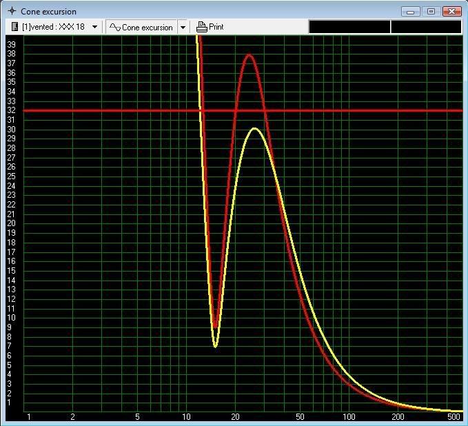

X cursion, XXX obviousley has more as it needs to move further with less Sd..expected..and not a problem as it peaks at 38mm, 16mm before it's Xmax... non issue

and the excursion graph shows the XXX destroying itself where as the maelstrom is just fine. (unless that graph's limit is wrong. remember that the further out the XXX goes the more distortion will be created compared to the maelstrom (XBL^2 coil).

Not sure where you are coming from. The comment about the excursion graph is not making sense in particular.
The XXX has a linear motor based on split coil and also has aluminum shorting rings and a full aluminum cap on the motor. It also has more cooling built in and more wire in the vc's in total. The suspension bottoms out at about 60mm inward stroke compared to 40mm for the MX. No doubt as to which woofer gets into trouble first. The extra SD does make up for a lot though.

my bad, i was assuming the line in the excursion graph was the limit line for the XXX. thus the comment of destroying the driver by exceeding its limits that much. I did not look up the actual excursion limit.
