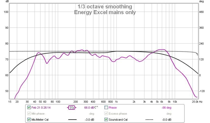

Got REW hooked up this evening. My setup is a Denon AVR2800 feeding two different sets of mains. A pair of Energy Excel bookshelves and a pair of BES/Bertagni planars (NXT style, dipole) and a DIY sonotube sub (Apex Jr. INF10 driver) being fed by a Mackie amp. I'm using a SB X-Fi external sound card and the RS 33-4050 SPL meter on a tripod at my listening position.
None of the measurements look all that great, but that's to be expected in an untreated room w/ hardwood floors. My main concern is the major drop-off above 8k. Is that accurate, or a typical symptom of the RS 33-4050 SPL meter?

Here's the Energy Excels. First alone, next w/ the sub

So, to reiterate, my main concern is the massive drop-off above 8k. Any insight there?
