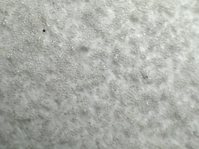

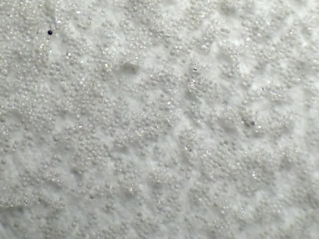

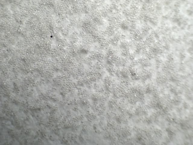

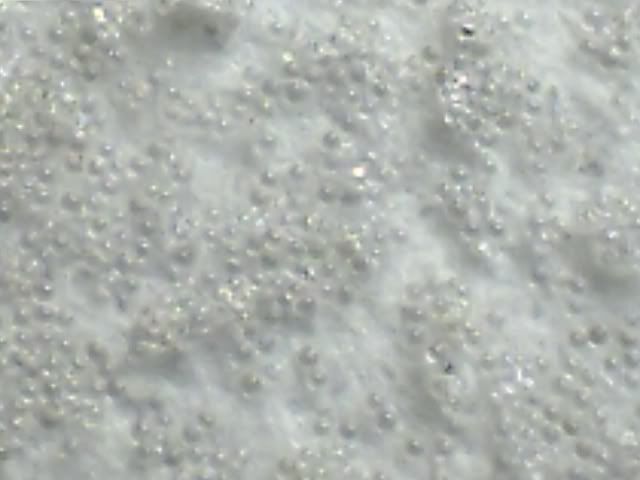

got a few microscopic images of the material to show.
my microscope has an optical zoom of 20x, and any further magnification is carried out digitally using a sliding scale upto 200x. so i cant say how much zoom has occured between 20x and 200x in an accurate manner. the higher magnifications have some noise/abberation artifacts due to this aswell.
20x
about 50x
about 100x
about 150x
200x

It turns out that beads in this size range are used in some type of medical research and costs can be as high as several hundred dollars per gram! At that price it would cost many thousands of dollars to make even a small size DIY screen.
Another problem is that as the cost of the beads goes down the size RANGE goes up meaning there are a number of different diameter beads in the container. Any bead over 50 micron is too large, and even 50 micron might be as well. The photo below shows what I mean. You can see some of the beads are at least twice the size of others. If you look close (and it helps to know what you are seeing ;)) you can see air bubbles inside some of the beads; I'm not sure how much that would interfere with their retroreflectiveness. The beads in the photo are supposed to be 50 micron in size, which is about 3 times smaller than the beads used in reflective road signs and road paint! Now for the real kicker... look past the beads to the surface they are resting on, THAT is a coat of the U.K. paint I referred to in my last post, and those little bumps are THEIR glass beads!
