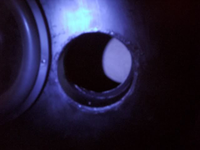

7.75" sonotube, 8" clearance from rear wall, resulting in 19.5" length, resulting in 15.4Hz tune
me inside the box to create "perfect" seal for port, t-nut

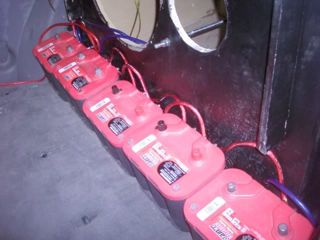

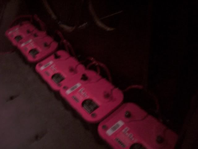

got bank?
running AC full headlights and fog etc...dome light on...while running
off

Bass I Love You has a 16Hz tone. I had more excursion at the 16Hz tone than I did on the 30Hz and 25Hz tones. Please excuse the very poor quality of this video, turn your speakers down! also note, very little port velocity. that 2 liter bottle barrely moves, and not much air blew through without the bottle in it either.
