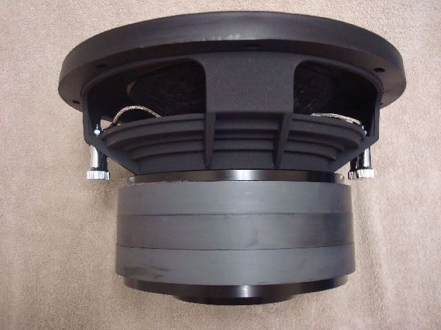

Here are some pictures From SSA's Mach 5 Forums
