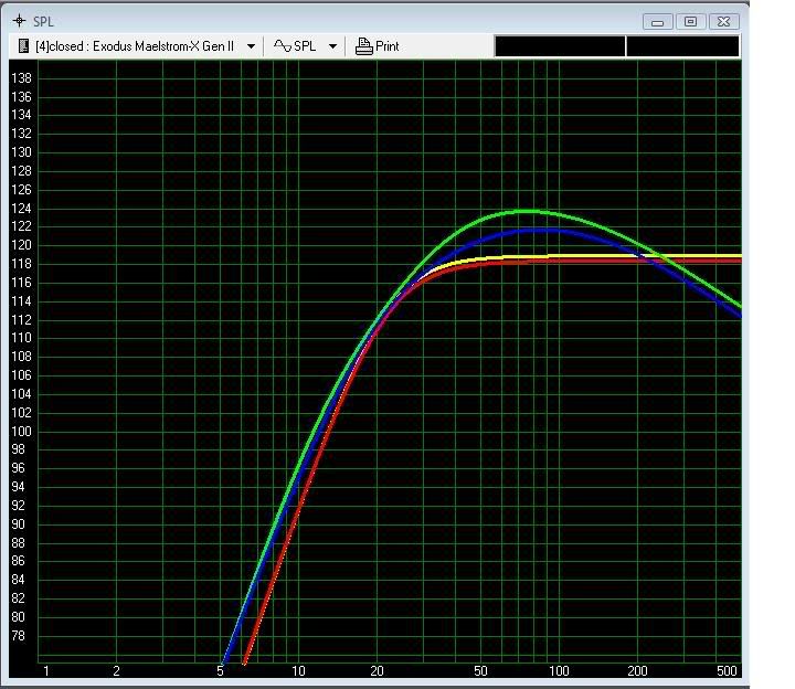

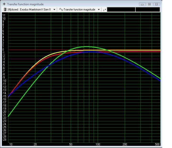

already workin on it! but I find only 999 works, one more 9 and it goes to... no good. Another thing that bothers me, drivers without Le maybe? When responce looks flat on the high end.
Anyway, I see the Qtc hump or whatever... IB3 appears much more optimal so far just under fr curve...I'll do excursion next and spl.
I doubt I do HP the right way, and powering I know I did "wrong"...
yellow IB3 default closed 154 cu ft 1000 watts ( it can thermally take it, especially free air...the 550 watts is a mechanical rating only) 20Hz HP
red IB3 999 cu ft 1000 watts 20Hz HP
green MX default 4.5 cu ft 3000 watts 12Hz HP
blue MX 999 cu ft 2800 watts 20Hz HP
I know I do it all messed up...anyone who wants to do it "proper" more than welcome.

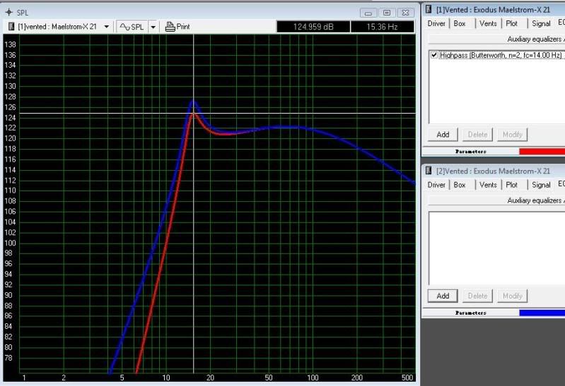

A single 21" Maelstrom ported sub tuned to 15Hz with 1600 watts rms in a 123 cu ft box.
HPF at 14Hz gives 121dB at 20Hz. 125dB at 15Hz. I'm trying to imagine what two of these are gonna sound like. YULKS!
sealed is MEH!
