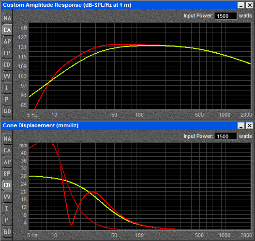

Well, after much research and forum trolling I'm going to be putting together a sub with 1 maelstrom and an EP2500. I really would like to stay within a 24 inch cube form factor and on a minimum budget. I'm debating between sealed or with 2 18" PRs.
So my question is - is the difference between these two responses worth the approximately $275 extra cost of the PRs.

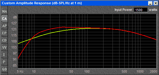

and with a conservative room gain estimate (6 dB/oct, +3dB at 25Hz)
As a note, I'm currently in a 2500ft^3 room

1,026 Posts
The graphs may be deceiving because it doesn't look like much. You get about twice the output down low near the PR tuning frequency in a slightly larger box with the PR build. It isn't a subtle difference. It is one of those HOLY SMOKES types of differences. It isn't like your hurting for output from a Maelstrom to begin with but the graph doesn't do it justice.

Thanks for the input Kevin. Yeah, I see that it's about a 4-5 dB advantage on those graphs in the low octave; the slope makes the gap look smaller. The other part I really like is the healthy advantage in the 30-35 Hz range.
1,026 Posts
You probably won't see 4-5dB. The simulation doesn't take into account all the mechanical losses nor power compression you see at those output levels. You get a lot though, and it is very low distortion. You basically have the swept area of TWO Maelstroms (PR-18) when the pair of PRs are operating and it is in the range that limits the output in most systems.
