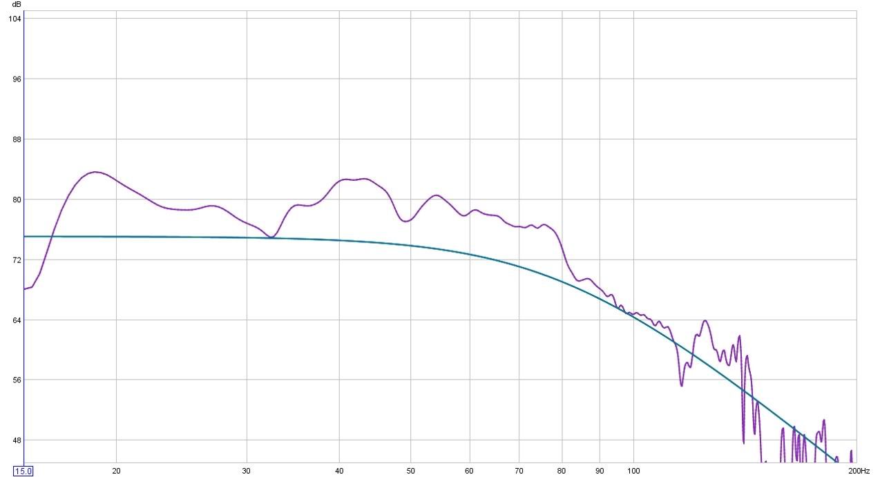

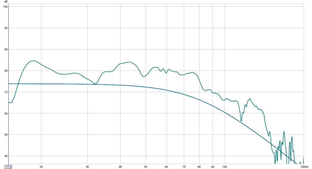

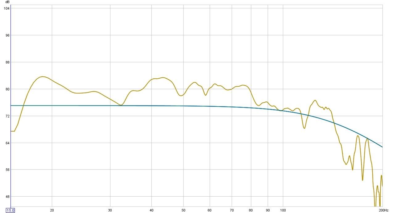

Any advice appreciated. If you think I should do something different and remeasure, I can do that. This is the best location for my sub based on experimentation (front corner for SVS and behind my seat for MBM).
Basically, I'm curious if I should equalize and/or get bass traps.
SVS PB10
HSU MBM 12
Treatments for reflection points (no bass traps)
I calibrated MBM and SVS using receiver test tone
Both subs (no mains), 80 receiver crossover; SVS crossed at 50hz
Both subs (no mains), 100 receiver crossover; SVS crossed at 50hz
Both subs (no mains), 150 receiver crossover; SVS crossed at 50hz

red: svs with mbm 80 hz xo on receiver, 50hz xo on SVS
blue: svs no internal crossover, 80 hz on receiver
red: svs with mbm 100 hz xo on receiver, 50hz xo on SVS
blue: svs no internal crossover, 100 hz on receiver
The answer is "yes." :)
It looks like you have about a 5-6 dB drop between 20-40 Hz - an equalizer could help that. An EQ could also help craft a house curve.
As you probably know, what bass traps do is truncate low frequency decay times. Yours actually look pretty good for an "untrapped" room. That 60 Hz thing is nothing to worry about, probably noise from an electric mnotor of some kind - fridge, A/C, etc.
To get the most from waterfall readings, you might want to add the mains and extend the graph's upper limit out to 300 Hz or so, since bass traps (if you get them) can improve decay up that high. It's best to keep your output levels 40-50 dB above the noise floor, and the graph's floor should be a good reflection of the room's ambient noise floor. A 45 dB lower graph limit is fine for frequency response readings, but kind of high for a waterfall, since most domestic rooms have ambient levels at least 10-15sd dB lower.
