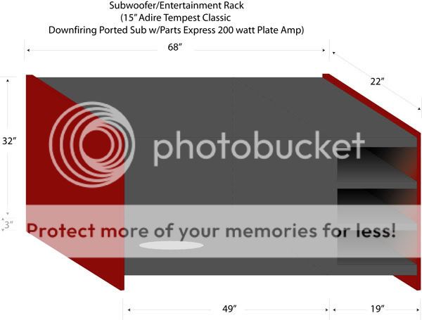

As a Newbie (this is my first post), I have come here for some advice. I have been researching how to build my home theater on this and many other sites for over a month now (Countless hours). It is amazing how much knowledge you must have to build a speaker. Anyways, I purchased a used Adire Tempest Classic 15" sub off a fellow member and a Parts Express 200 watt plate amp to build my sub. I have finally decided to build a TV Stand/Subwoofer, although my TV hangs on the wall. Ive included a design that I would like to build with the maximum size available. I was wondering if one of you professional builders could look at it and tell me a few things. I need to know if the box is too big or too small for the sub. Also what size vent/port I would need for this sub taking into account of the displacement and any structural supports. I know it wont be exact because you dont know how many supports Ill be using, but I think if we can take a rough estimate we will be close. This is my first build in home audio, although I have built many car audio systems. I have downloaded all the software needed to do this, but it is a huge task to try and learn it all so quik. Over time I will be learning all this, but for my first build, I just want to get started.
I am not afraid of hard criticism and actually appreciate it, as this is how I will learn. Thank you in advance all that help me, as Im really excited to start my first home subwoofer.

19,397 Posts
Will the shelves on the right hand side go the whole depth of the cabinet, and will the sides have a lip on top and front as shown in the pic? The bottom of the sub cabinet should be 4 inches off the floor instead of the 3 inches shown. If you could figure out the internal volume of the sub cabinet it would help a lot.
If they go the whole length you may want to think about making a seperate matching stand for the electroncs. Subs vibrate and electronics don't like to be vibrated.

I read the Thiele/Small article and understood about 4 words. No really, I did read it, but will have to read it a few times to understand each parameter and its use. As far as the shelves on the unit, they do go all the way back. I thought about the vibration, but then thought that this unit will weigh a ton. Do you still think it would vibrate weighing as much as it will? I dont know if there will be a lip on the front or not yet. Will this make a difference? I dont know which amp it is yet. It will arrive today. I bought it used. Thanks for the comments, keep em comming.

Lets just go with the internal space it has now, just a square encloser. You can leave the lip or lose it, whatever works better. If you need to make it smaller you can. Lets figure in the fact that it will be made of 3/4" MDF and a reasonable amount of bracing. I will need some extra 2X4's along the top and bottom to prevent sagging over time. If we make it just a square box and use those measurements, Ill make it look good later by adding some trim pieces and so forth. Do all the dimensions show OK in the picture? Also tune it to what ever you think best for that sub and use in a home theater. My room is approx 15' X 20' with vaulted ceilings and hardwood floors. I sure appreciate all your help.
19,397 Posts
As drawn with a one inch lip on three sides and 4 inches off the floor instead of 3 inches, the internal volume would be 12.5 cu.ft. with a 1.5 inch bottom baffle. Subtract displacement for the sub ports and bracing would give a net volume of 11 cu.ft. Tuned to 17 hz with two 4 inch flared ports each being 18.25 inches long will give you 107db at 20 hz with 200 watts input power, plus room gain. This is assuming the plate amp has a subsonic filter at 18 hz. With this set up the sub could handle 350 watts without exceeding Xmax and give you another 3 db, if you should decide on a bigger amp in the future.
