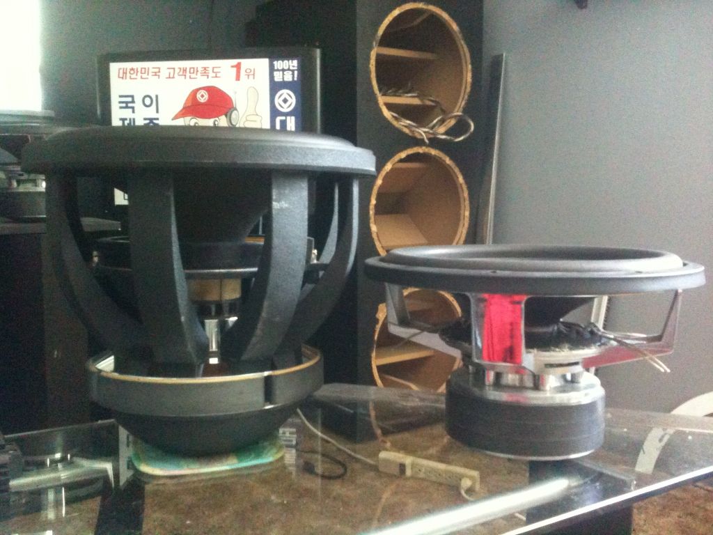

I have a re xxx 15" sub. Want to use it as a ht sub. For music and movies. I dont have a computer right now so lost all my programs i used to use. MIKE P. helped out a lot on my last build. I want either sealed or ported. Not sure which would work best but pretty sure vented. Would like to use multiple 4" flared ports with dimples. Want to see how much better they are compared to the normal flared ports. Heres a pic with the xxx next to one of my 15's im building for the car.
Thank you as always for all your help.
15" RE XXX
dual 2 ohm
Displacement .27 ft^3
Qes .58
Qms 3.62
Qts .501
Fs 19.10 hz
Vas 207 liters
Xmax 54 mm
Efficiency 85.81 dB SPL
Sd 810 cm^2
Rms 2000
Bl 18.16
Mounting depth 13.5"

Thanks again for your help. Your always saving me. Lol. That looks good. My last setup was the 15" re se with the (2) 15" maelstrom PR's you helped me with. That turned out great. So i might try sealed this time. That box was pretty big if i go ported will be even bigger. Lol. I listen to a lot of music so i think sealed will sound nice. Thanks again. Ill post a sealed thread when its built.

I got a really good deal on the sub only paid $300 for it. Im currently looking for another one so I can have one in my HT and one in my car. I have 2 sets of RE XXX 6.5 comps in my car now and have a AQ3500 for the sub and that produces 4300 watts rms at 1ohm. From everything I have read these subs love the lower frequencies but are not that good with upper hz. Im going sealed to keep the footprint a bit smaller than vented lol. Thinking of a finish but will be using a 3/4" thick acrylic window to see the monster basket n motor. Right now im thinking Gloss Piano black with stainless accents.. want to keep it elegant looking. any suggestions on a unique finish? Thank you for your support. hope it turns out well. lol
