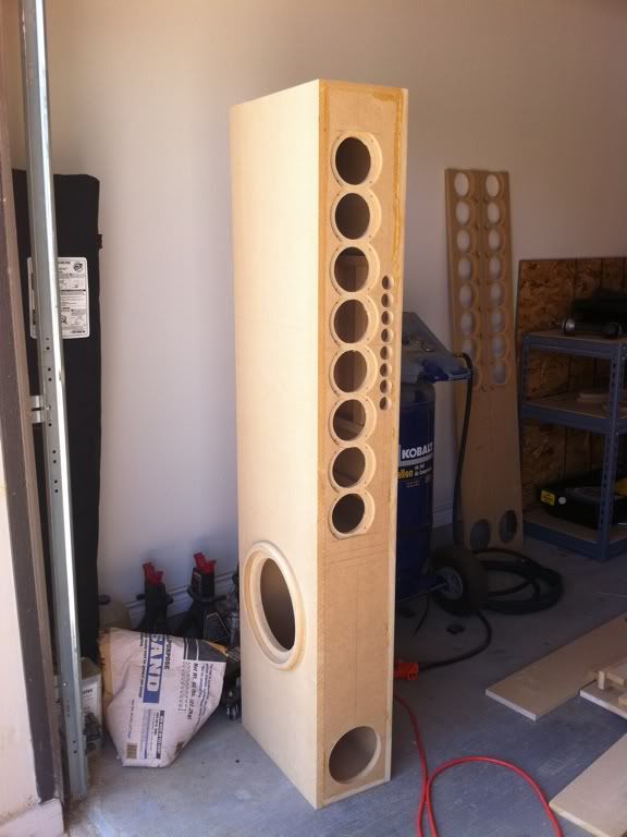

I've been traveling a lot for work and haven't been able to make as much progress as I'd like. I did get one of them together last night. Progress will come but it will be slow.

And sorry for the delays. I've been traveling quite a bit and I'm finding it hard to get enough time to put in on these. Hopefully I'll have some time this weekend.

There will be more progress on these this week. I'm planning on being in town this week (fingers crossed) so I'm thinking I'll be able to put some time on them.
I have put both of them together now. Next steps will be wood filler, routing the edges, sanding, sealing, sanding, priming, painting....in that order :D

I purposefully left about 1/64" knowing that it would sink down a little when the sub got tightened down due to the gasket. I'm also planning on using some silicone on the tops of them to interface with the motor.
Other than that it's all done up with wood filler in anticipation for the belt sander that should arrive later tonight. Then progress will pick up. :D

New sander arrived after 8pm last night so no work got done. All the wood filler has been applied and we're ready for sanding later today!

Ok, I've been holding out. The guy I got to paint these did a bad job the first time on one of them and I asked him to do it again. He did and things came out much better. So I finally got around to making the wiring harnesses for these things. Yes, wiring harnesses. Wiring 8 midbass and 16 tweeters takes a little planning.
Pictures.

I appologize for my absence, I've been strapped for time lately.
Crossover will be done this week. I heard them without the tweeters running and the midbass running full range and it was fairly impressive. I know that when I get the whole line going it's going to be incredible. I'm expecting efficiency to be right about 96db. We took measurements all day yesterday and the cabinet tuning is right where we want it. I was worried that two 4" ports in the rear for the midbass drivers would be too much but I think it's going to be great. I almost didn't believe Unibox when I was modeling them.
