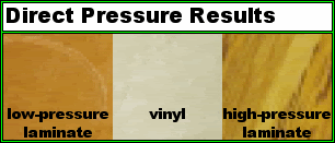

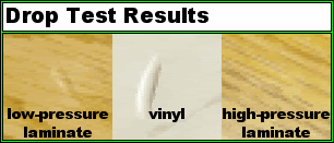

Durability: What's The Damage Resistance of Laminates? Wilsonart is a manufacturer of High-Pressure Laminates used for floors and countertops. They did some testing to show the potential for damage on various materials. Here are the results for Low-Pressure Laminate, vinyl surfaces, and High-Pressure Laminate:
TEST ONE - Impact Resistance
Laminate planks were laid on Wilsonart Flooring’s 2-in-1 Pad and placed on concrete. A simulated can weighing 396g (the weight of a 14 oz. can of Campbell’s chicken soup) was dropped vertically from a height of 36 inches (standard countertop height) so that the simulated can impacted the surface.
TEST TWO - Constant Pressure Resistance
Two inch square samples were subjected to static load in accordance with AST F970. Loads of 2,000 psi were placed on each sample for 24 hours. After testing, samples were allowed to recover for an additional 24 hours in a room conditioned at 22c / 50% RH before inspection. After the recovery period, samples were inspected for damage.
