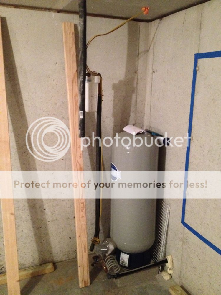

I'm moving this water pressure tank next weekend so that it's out of the theater:
