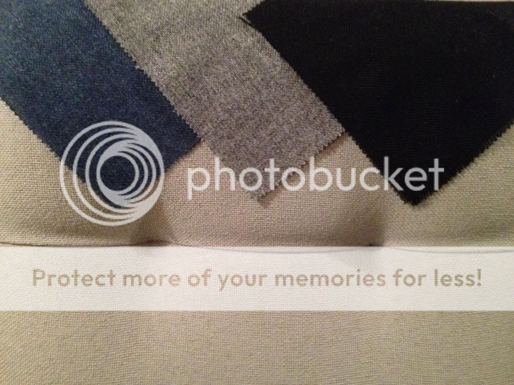

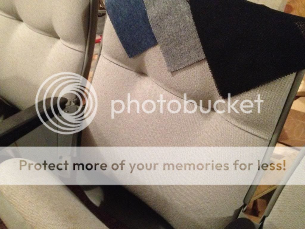

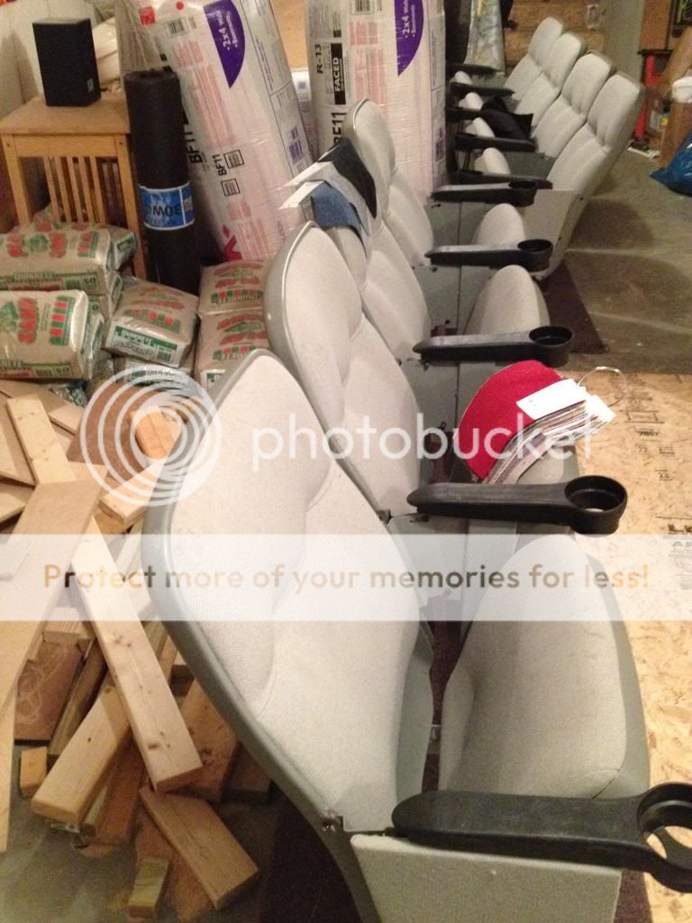

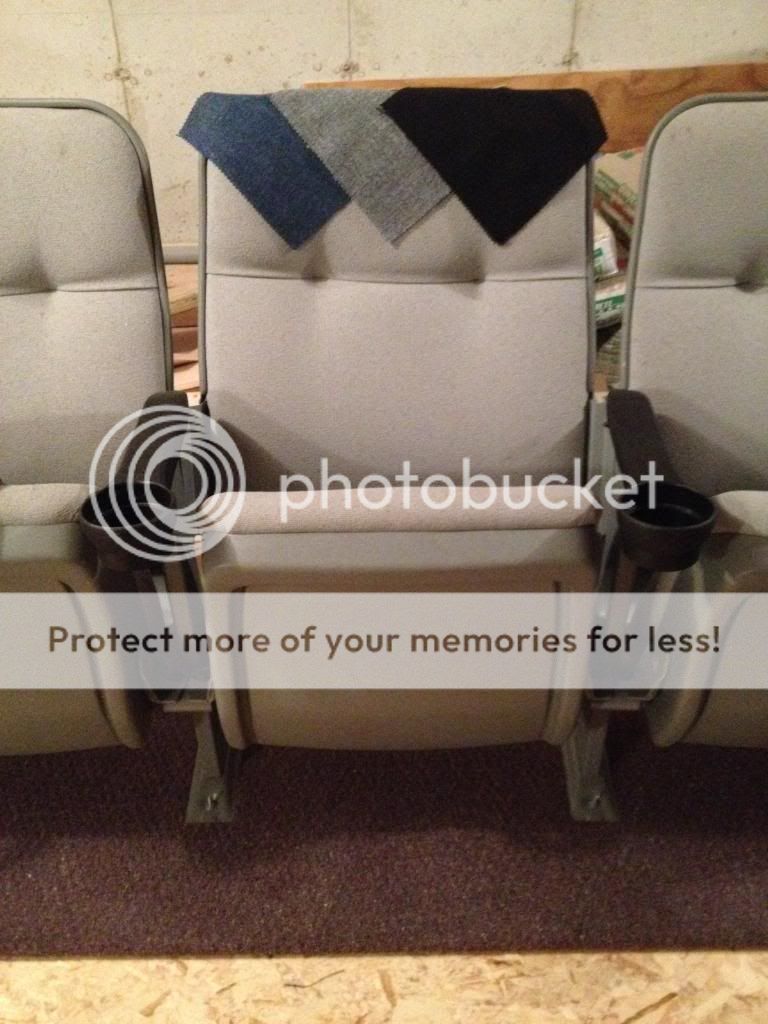

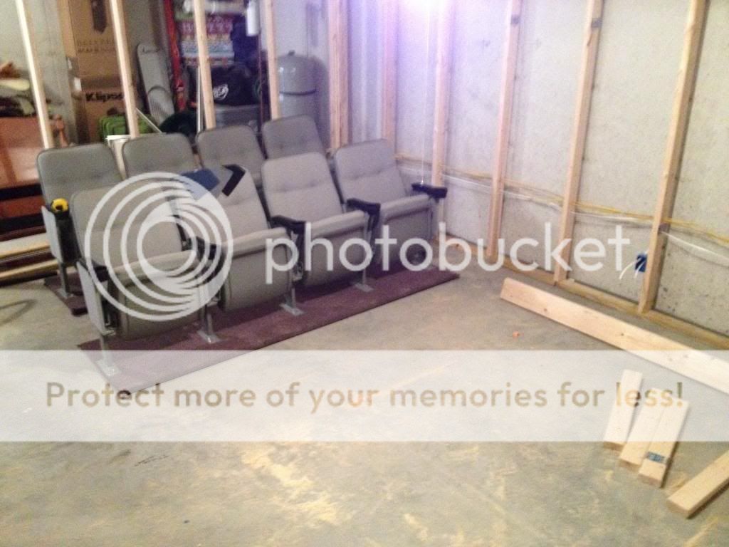

Picked up the theater seats yesterday and I brought home my GoM FR701 samples to pick out colors.
Pardon the mess!
I forgot to take a pic of the carpet but it's the one pictured below which has blue tones in it and the field color is called black but actually has dark blue/purple in it. My plan is to carpet the floor with this and a cheaper solid black for the riser and stage to save on cost.

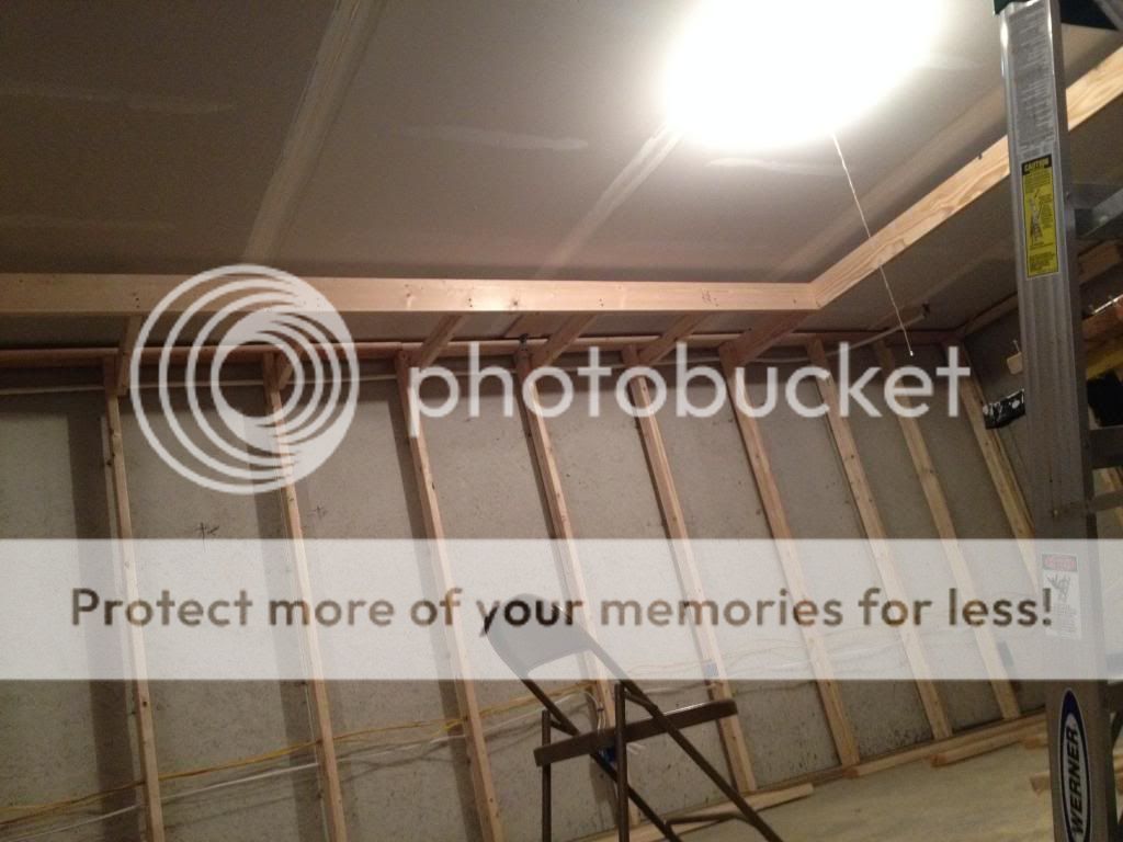

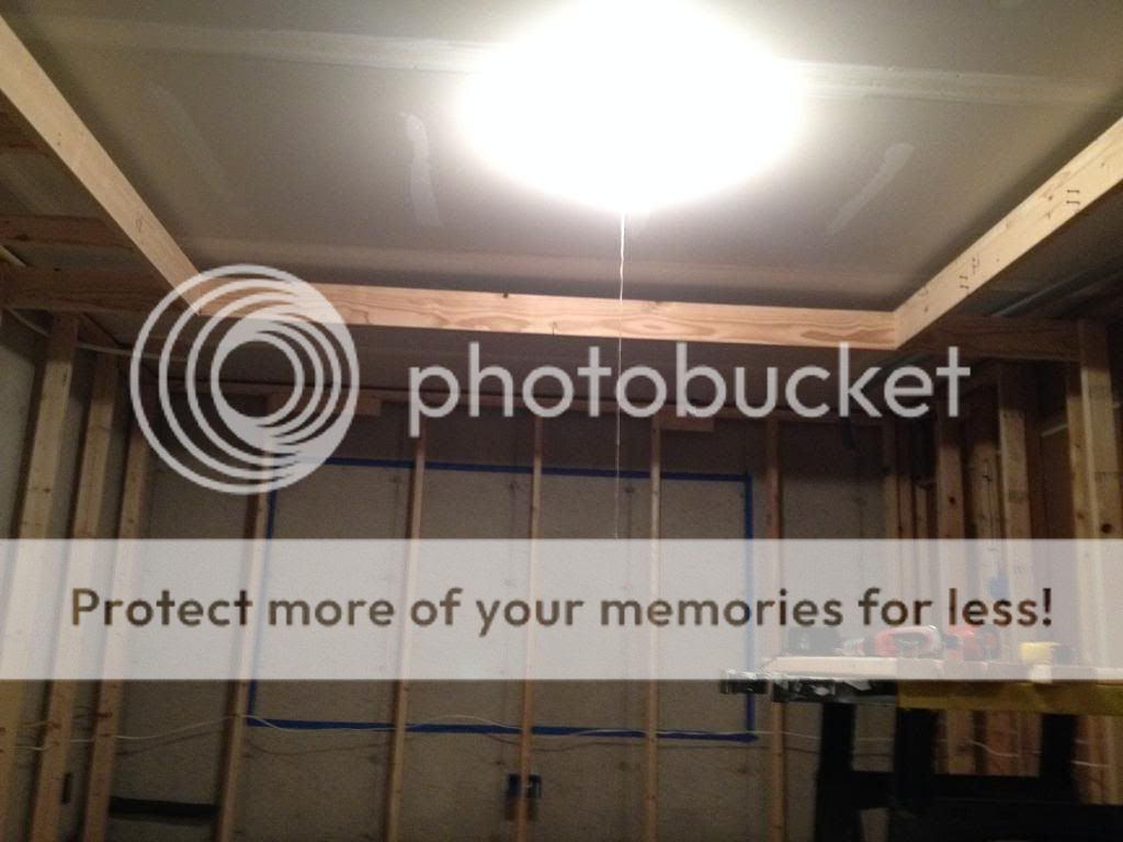

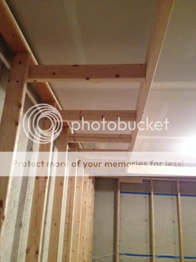

I've also got about 60% of the soffits built.
Looking up from the HT door.
Along the left side of the HT.
From second row (knealing).
Next up is to finish the soffit framing, build backer boxes for the electrical boxes and lights, install the conduit to the PJ and to the stage and then I can insulate!

Looking forward to seeing the final ceiling. The shallow soffits look cool, a little different than the typical standard framed ones. So they're decoupled from the ceiling, and attached directly to the joists with the strong ties? I don't think the strong ties are visible in the pics above, but hey, if you can hang on them, they're good. I can't remember if you planned to have some rope lighting up there, in addition to the stars?
#37 ·
The existing ceiling is going to remain. The framing is held 1" down from the existing drywall and is supported at the top plate using DC04 clips bolted thru the existing drywall ceiling into the existing floor trusses. The soffit was then "hung" from the wall framing using 2x6's which create the perimeter of the inside of the soffit and I used the Simpson screws with hex heads at the connection points. The soffit joists are held tight to the underside of the wall top plate so that there is in effect a 2.5" gap between the top of the soffit frame and the existing ceiling. The intermediate soffit framing is 2x4's so that's why you see a gap between the top plate of the wall and the top of the soffit framing. I will the frame the ceiling with 2x4's across the room @ 24" O.C. with batt insulation within the spaces and then I will hang my new ceiling drywall from them. I had purchased and might add the Simpson support angles at these new ceiling "joists" for piece of mine, but like I said, I can do pull ups without it flexing...
I'm going to do the DIY star ceiling, following ALMFamily's design, and the seven 3" can lights within the soffits. I'll add rope lighting to the risers edge and might add some below the theater seats so that people can get to their seats without having to turn on the other lights.

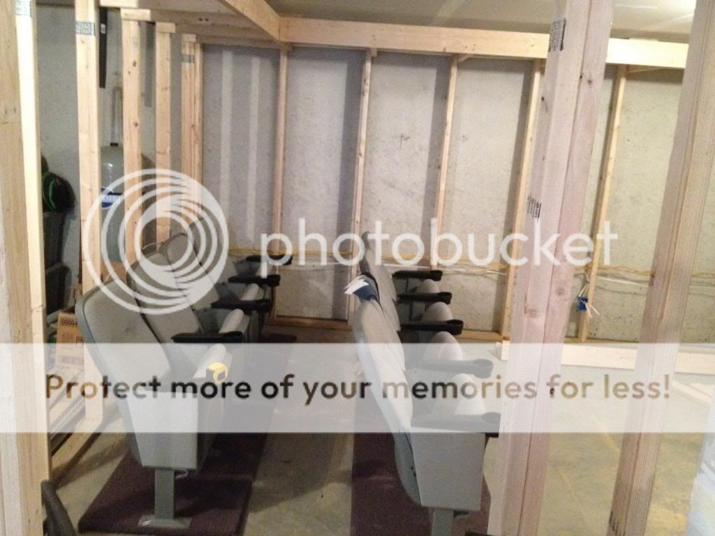

I temporarily pushed both rows of theater seats into the room to see how they fit and check for clearances and I MIGHT be able to use both rows AND a couple of recliners for the first row... But I'm going to finish up the room with the drywall before I can truly decide. It is TIGHT, but might be feasible. It also might force me to change my screen size to accommodate but I'm okay with that. We'll see.
I might go down to 3 seats at the back, centered in the room and then 4 for the middle row and offset them so that the people in the back row are looking through between the people in the row in front of them. They are aligned in the picture but I'm going to look into offsetting the rows and putting the back row on a 8.75" riser (need to study headroom further) and the middle on a 4.375" riser with the potential for a couple of recliners on the floor.

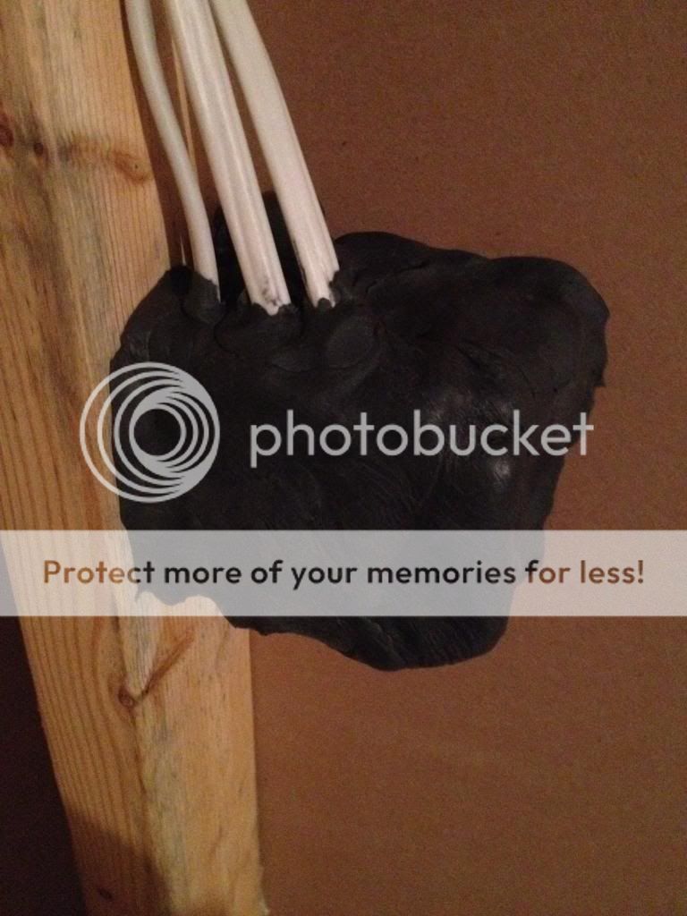

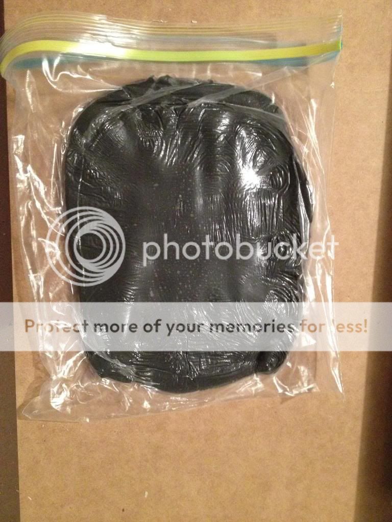

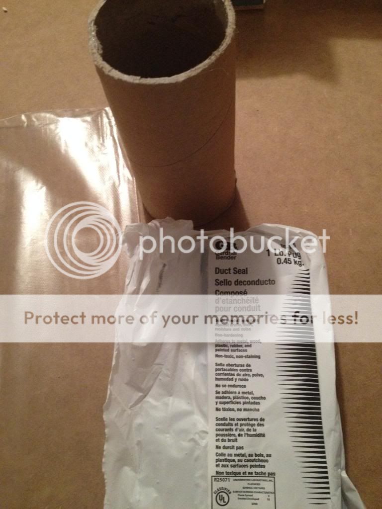

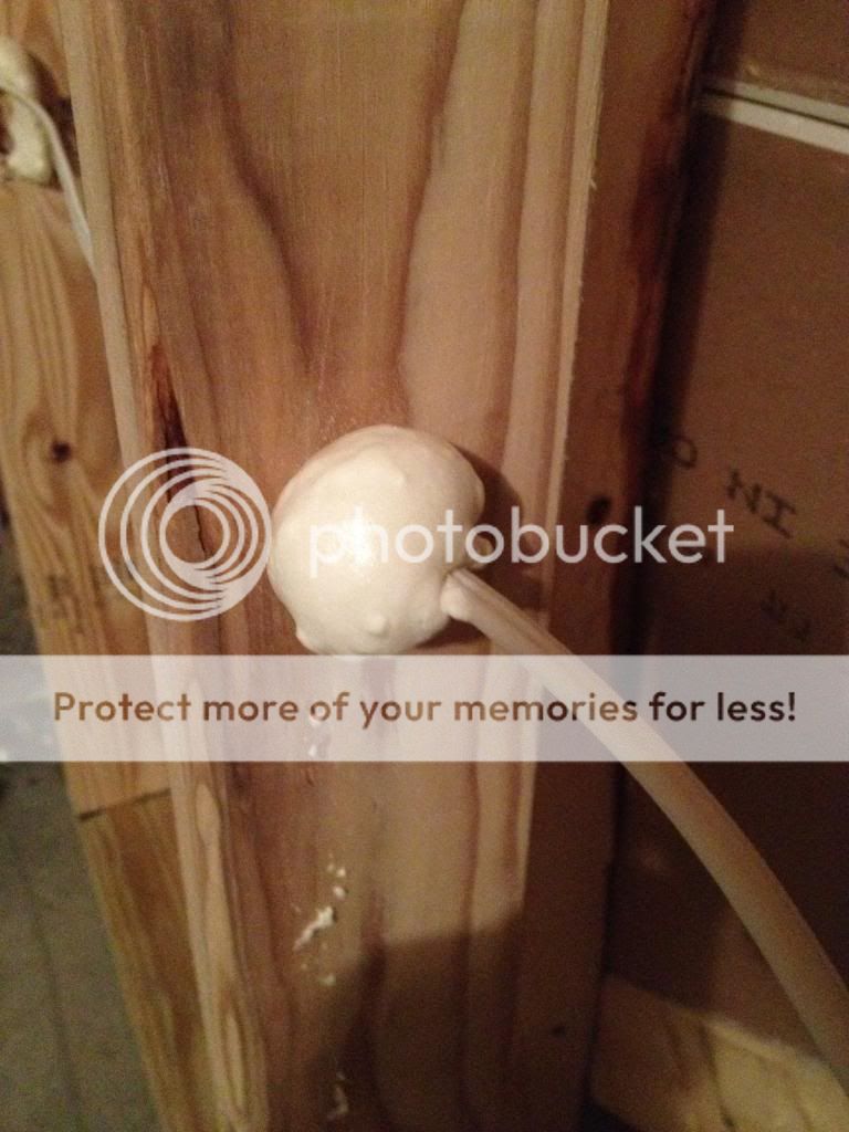

So I decided to try making my own putty pads out of the Duct Seal found in the electrical dept at my local HD. I used gloves, a plastic bag and a cardboard tube I had laying around to flatten out the thick puck that you get. This stuff is sticky! This was a trial and I think next time I'll see if aluminum foil will work better since it stuck to the plastic bag and was hard to seperate. Overall I think it should work out well and they are only $2.48 a piece plus I have $5 off when you spend $50 coupons. So in all I can make 20 for $48 after tax and a little bit of DIY labor.
I also used the foam-in-a-can to make sure my wiring doesn't create unwanted noise within the walls.

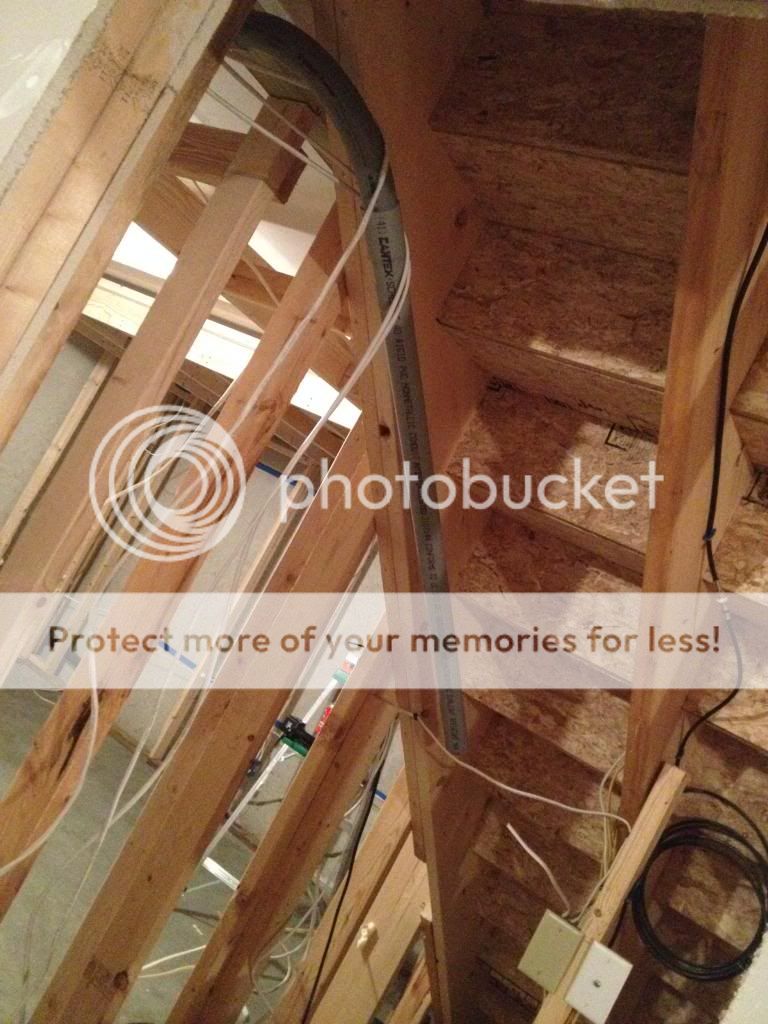

I also ran my conduit which comes down from above the soffit framing, along the stair framing and into the "hidden room" below the stairs. I can access the end of the conduit from the hidden room and this will allow me to make a nice, clean finished equipment room. More on this later.
The picture doesn't show the plastic ties I used to fasten the conduit to the framing...

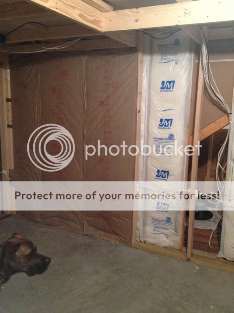

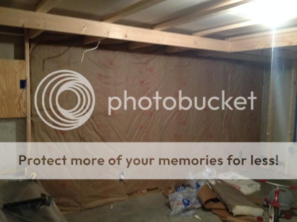

And we've started insulation folks!!!
The JM plastic wrapped insulation is within the stair wall and the 23" wide OC paper faced insulation is in the HT wall so that each wall has insulation. It's getting much quieter in the HT now! I got 2-3 hours to work on the room tonight while the kid, the wife and the neighbor watched The Croods upstairs.
Notice the plywood blocking for the rear surround...
