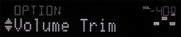

4. Press the Option button on Receiver Remote Control and Volume Trim will appear on the front display of Receiver.

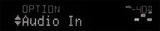

5. Using Arrow down button on Receiver Remote Control, scroll down to Audio In.
!!! MY PROBLEM IS HERE !!!
I don't have the option for "AUDIO IN"
My AVR is updated to Firmware K032 and Checksum 8FFD (which according to Yamaha this update should allow me to reassign like I want to...)

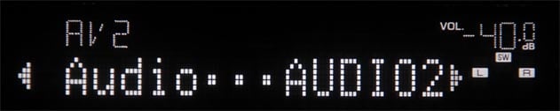

6. Press the Enter button on the Receiver Remote Control to enter Audio In Menu.
7. Use Arrow button to the Right to move to Audio 2.
8. Press the Option button to exit Option Menu.
9. When AV2 is selected on the Receiver it will look to Audio 2 for the audio signal.
