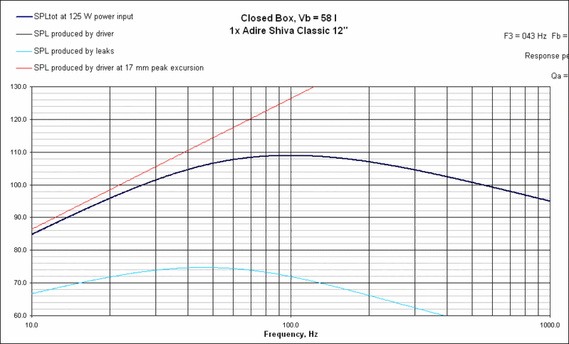

Is it a powered sub? If it is, do you know how much power it is capable of producing at a 4ohm load?
Also, if it is powered, I've always felt projects like this (driver swaping in commercial subs)were risky since there is no way to determine whether or not there is any form of EQ going on, there usually is. Each part of a pre-built sub is designed specifically to work with the original parts. If you can ball-park the internal volume you'll know just a little of whats necessary to have a good sounding sub.
If its just a driver in a box, replacing the driver would be way less risky. You'll have the option to choose between many aftermarket amps.
G
It is a powered sub with, i believe, a 125w amp. I've been kinda concerned about some preset EQ within the amp. I'm assuming that Kyle, with Acoustic-Visions took all this into consideration when he recommended the Shiva.
So you've already spoken to Kyle already, good. I assume he took preset EQ into consideration as well. However It doesn't hurt to ask him, for reassurance.
This is what you'll get, before room gain and with a steady 125watts of power.
Edit: I accidentily gave the box a few extra liters...wont make much a difference ;)
G

EQ aside, I didn't think that you could use the same box with a different driver. The volume of a box is determined by the Thiele-Small parameters. Since these drivers are different, I'm pretty sure the box will have the incorrect dimensions for the new driver.
Here is a link to Unibox -- and WinISD. Both sites have a free download that can help you figure out the correct internal volume for a given driver. In either case, you will need the T/S parameters.

I totally agree that using the box from a commercial sub with an aftermarket driver is risky. However, in this situation the shiva classic looks pretty **** good in a box this size, which i've already shown in the above graph (which takes T/s parameters into the account). Not only is it capable of decent output, it does so with acceptable Qtc, all it needs is some acoustic stuffing. I'd say covering the walls at least.
Add 2 lbs of fiberfill, slap a shiva in there and pound away! Sealed subs are very forgiving and adding a shiva will help with the lower extension. Also, with the Shiva, you can later upgrade the amp, then maybe a bigger box. i think you will like the results. Good luck.
